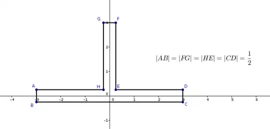

In Evans' book Partial Differential Equations, 2nd Edition, On page 33, Line 5, Evans wrote that:" Since $V$ is connected and $\overline{V}$ is compact, we can cover $\overline{V}$ by a chain of finitely many ball $\{B_i\}_{i=1}^N,$ each of which has radius $r/2$ and $B_i\cap B_{i-1}\not=\emptyset$ for $i=2,\dots,N.$" My question in this part is that: How to construct such a chain of finitely many balls? This is my first question. For example, suppose that the $\overline{V}$ is as the set below: enter image description here
That is to say, $\overline{V}$ is the set bounded by the line segments of $AB, BC, CD, DE, EF, FG, GH$ and $HA.$ And suppose that the radius $r/2$ happens to be $3/2.$ How could I construct a chain of finitely many balls $B_i ~~(i=1,\dots,N)$ of radius $3/2,$ such that $$\overline{V}\subset \cup_{i=1}^N B_i \text{ and } B_i\cap B_{i-1}\not=\emptyset, i=2,\dots,N.$$ I have tried using Heine-Borel Theorem, but is able to find a famyly $\mathcal{F}$ of finitely many balls of radius $3/2$ such that $\mathcal{F}$ covers $\overline{V}.$

To construct one with your example, start at the top, and work your way down in intervals of say $1/2$, taking balls of radius $3/2$, when you get to the bottom, go left taking more balls, then when you get to the end, go all the way right until everything is covered.
