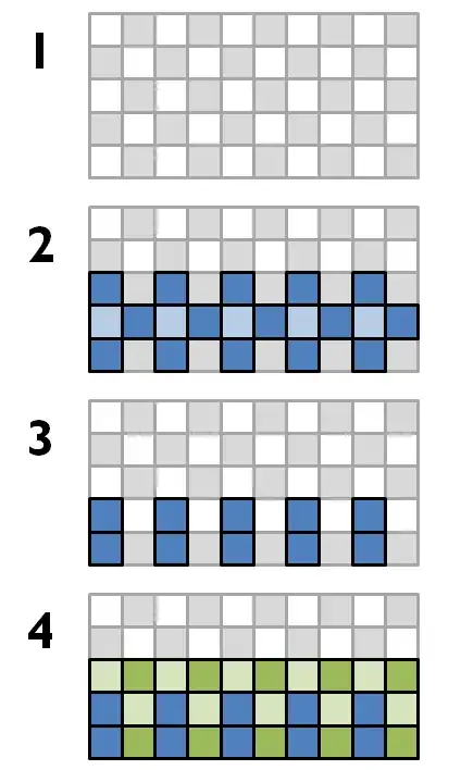

My colleague, Ido Segev, pointed out that there is a problem with most of the elegant proofs here - Tetris is not just a problem of tiling a rectangle.
Below is his proof that the conjecture is, in fact, false.

    It seems, in light of this counterexample (+1 btw), that the conjecture could be refined to improve the notion of "number of pieces" involved in a perfect clear, where the involvement of partial pieces was made more explicit. Although I wonder if allowing partial pieces makes for too many degenerate cases, destroying the hopes for any meaningful conjecture about partial piece perfect clears. – Greg L Nov 10 '11 at 18:43
    @Graphth Would someone explain the picture Gilad has shown and how this answers Eric's question? –  Dec 14 '11 at 00:32
  • 11
    @SivaramAmbikasaran The question is, can we have an odd number of T pieces at the time that everything is cleared. The pictures show that if you start with 5 Ts and then 5 Ls, and play them just right, you will have a perfect clear. So, this answers the question, yes, it is possible to have an odd number of Ts before a perfect clear. – GeoffDS Dec 14 '11 at 01:08
  • @Graphth: Thanks. I got it. –  Dec 14 '11 at 01:20
  • I don't get what Gilad is telling in his answer, so could please someone explain ? I can see the T's with the points to the right in step 2, but I don't see what step 3 and 4 are about... Thanks in advance – Saryk Oct 09 '13 at 08:51
    @Saryk In step 2 the second row from the bottom is completely filled and as such gets cleared. In step 3 we see the remains of the T pieces (just the top and the bottom parts of the pieces with the middles cleared out). In step 4 the gaps are filled with L pieces to make a perfect clear. – SamYonnou Oct 11 '13 at 12:27
  • @saryk You could say its a game of clearing lines and not just placing a tetris. – Joshua Herman Jan 12 '16 at 06:49
    Modern Tetris requires that all pieces be dropped using the "7-bag" approach (where each set of 7 pieces is a permutation of the 7 types). Does that affect the correctness of this answer? There's simply no way to have such a convenient setup as shown in this answer, at least on regulation Tetris. (Obviously older/non-compliant Tetrises could provide this situation in extremely unlikely or RNG-manipulated circumstances.) – fluffy May 17 '20 at 19:16
  • nice observation @fluffy. with the bag approach, this is impossible, also, probably the conjecture means that if you have T pieces but are not yet modified or cleared in any sense that the parity property remains, then it should be an even number, in this proof, the imparity is removed when the middle line is cleared, so we can argue that there are not T pieces when you do the perfect clear – rahpuser Jan 13 '23 at 16:18
