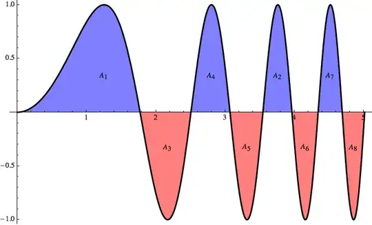

Yet another hint: Think in terms of alternating series:
$$ \int_0^{\infty} \sin(x^2) \, dx = \sum_{n=1}^{\infty} A_n. $$
Mark McClure
  • 31,496
  • Although one can reason easily that $A_n$ decreases, is there a way to show it formally? – MT_ May 14 '14 at 12:19
    @MichaelT Yes. The zeros are where $x^2 = 2\pi k$. Thus the $A_n$ are bounded by something like $\sqrt{2 \pi (k+1)} - \sqrt{2 \pi k}$ in absolute value. – Caleb Stanford May 14 '14 at 12:25
  • @Goos I suppose you mean $k\pi$, not $2k\pi$. That shows that $A_k\rightarrow 0$, but MichaelT asks why are they decreasing? Perhaps a bit trickier. – Mark McClure May 14 '14 at 12:50
  • @MarkMcClure You're right, it's a bit harder than I thought. – Caleb Stanford May 14 '14 at 12:56
