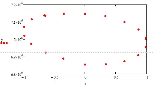

If you were to plot this in Mathcad you will get the following:
Plot of Ellipse Points

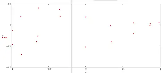

What I get is as follows:
Fit values
I guess my question is - what am I misunderstanding here? How do I use the output from the fit (a, b, ... f) to plot an ellipse which is centered on $ (0.0116,7006431) $ and can be superimposed onto the original data?

You don't have a function $F(x,y)$, that would imply that you have some 3d object. you have an expression $ax^2+bxy+cy^2+dx+ey+f=0$.
You need to plug in $a,b,c,d,e$ and $f$ for $ax^2+bxy+cy^2+dx+ey+f$, and then, for each coordinate pair you want plug in either x or y, and then solve for the variable you didn't plug in.
What you did was make a form of error plot.

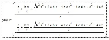

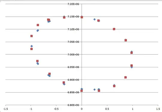

Ok, what I have done is to determine the y value from the x:
y(x)
I have then determined y from x and plotted on top of the original data (blue points are the fitted values, red are the original):
Thankyou for your assistance.
Mike
