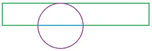

The rectangle pictured above, with the Euclidean metric restricted from the plane, gives an example where the closure of an open ball of radius $r$ is not the same as the closed ball of radius $r$. The segment inside the pictured circle (not including endpoints) is an open ball, and its closure is the segment including the endpoints. However, the closed ball with the same radius includes the point where the circle is tangent to the rectangle.
Because closed balls are closed, the closure of an open ball of radius $r$ is always contained in the closed ball of radius $r$, so the only way for the two to not be equal is for the closed ball to contain points not in the closure of the open ball.

4To be explicit: by rectangle you mean the green segments shown, not the interior. – Ross Millikan Nov 05 '11 at 16:46
Ross: That's right, thanks. – Jonas Meyer Nov 05 '11 at 16:51
