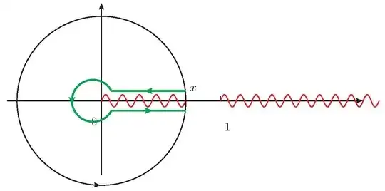

There they want to evaluate the integral $$\oint_{|\omega|=x}d\omega\:(1-\omega)^{-3/4}(x-\omega)^{-3/4}\omega^{-3/4}$$ enter image description here
where $x\in]0,1[$ and they get $$(-1+e^{-i\frac{3\pi}2})\int_0^xd\omega\:(1-\omega)^{-3/4}(x-\omega)^{-3/4}\omega^{-3/4}.$$ (Which is essentially the integral representation of hypergeometric functions). Since the integrand is multi-valued and has branch points at $\omega = 0, x, 1$ we should probably make a branch cut on the positive real axis. If I naively deform the contour into a line from $x$ to $0$ above the real axis and a line from $0$ to $x$ below the real axis, I seem to get the right result. But that can't be correct; due to the branch cut the circle is not closed and we need to cross the cut several times to get back to the original Riemann sheet and close the contour. But when I do this, taking into account the phases accumulated while going around the Riemann surface, I don't get the correct result. How is this done right?

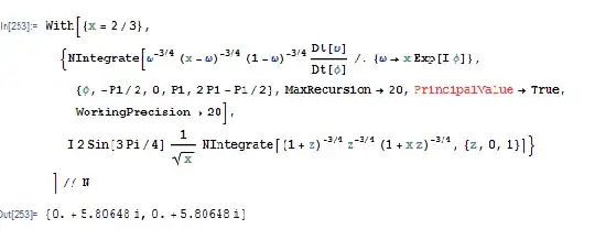

Now, let's check this with quadratures:
Notice that the purported answer you gave in your post can not be correct, as it is not purely imaginary.

I think the authors get the answer just by contour deformation from the circle to the green line. Suppose above the branch cut $(0,x)$, the integrated function is $$(1-\omega)^{-3/4}(x-\omega)^{-3/4}\omega^{-3/4}$$ When the contour rotates around $\omega=0$, we have $$\omega\rightarrow \omega e^{2\pi i}$$ and the integrated function becomes $$e^{-3\pi i/2}(1-\omega)^{-3/4}(x-\omega)^{-3/4}\omega^{-3/4}$$
