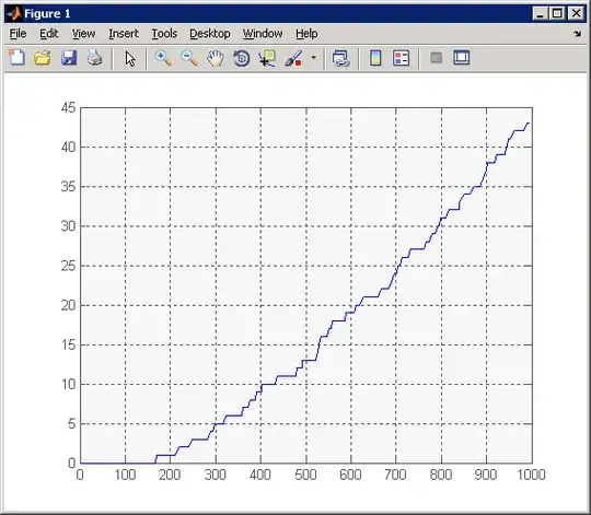

Using these rules to check for divisibility by 2, 3, 5, 7 and 11 the only false positive less than 200 is 169, which is easy to remember as it is $13^2$. The only false positives below 300 are $221=13\times 17$, $247=13\times 19$, $289=17^2$ and $299=13\times 23$.
Edit: Just for fun, here's a graph of how many false positives there are for a given upper bound. This chart shows that with four rules and a list of 13 exceptions, you can correctly find whether any number under 500 is prime or not in... probably 20-30 seconds?
