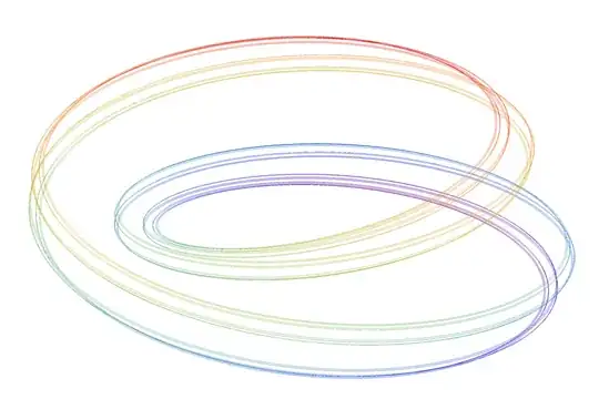

They are a bit like a solenoid as shown below, except they are not homogeneous spaces. Given a regularity condition known as repetitivity which I won't write here (a Penrose tiling is both locally finite and reptitive) a tiling whose tiles are polygons meeting edge to edge has a tiling space which fibers over the $2$-torus $T$ with fiber homeomorphic to a Cantor set. You can think of moving around the torus as translating the tiling by small amounts, and then hopping a small discrete distance from one point in the Cantor fiber to another corresponds to making a different choice of placing a tile far away from the origin, but everything else closer in than that tile is the same.
The dyadic solenoid
