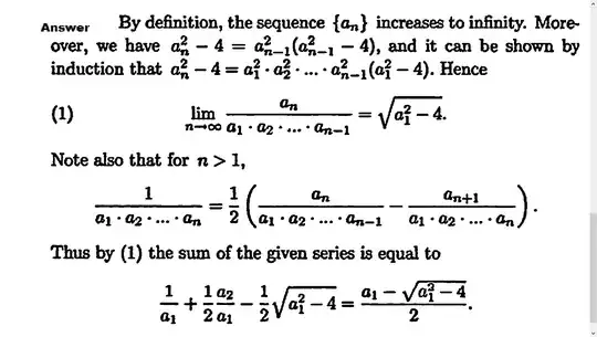

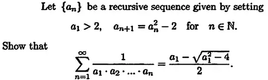

A related question.
And its answer
Mohan Sharma
