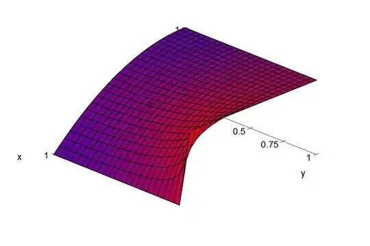

Question 1 - But how is the fourth vertex $(x,y)=(1,1)$ transformed? In the plot below of $\dfrac{1-x^{2}}{1-x^{2}y^{2}}$ seems that the following limit does not exist
$$\underset{(x,y)\rightarrow (1,1)}{\lim }\sqrt{\dfrac{1-x^{2}}{1-x^{2}y^{2}}}.$$

Question 1: Setting $u=\pi/2-v$ in your first set of formulas gives $(x,y)=(1,1)$, so that point corresponds to the whole hypotenuse $u+v=\pi/2$.
