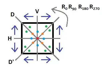

Motivation: In some cases, there are so many kinds of orbits of G on Ω that every subgroup of G appears as a point-stabilizer. However, these actions are quite rare, even in the case of a point group of a group of Euclidean isometries. (The only such actions in 2D are C1, D1, and Cp for primes p. This follows because rotation subgroups only stabilize the origin.)
subgroups as isotropy subgroups (example for D4 by Bill Cook).
