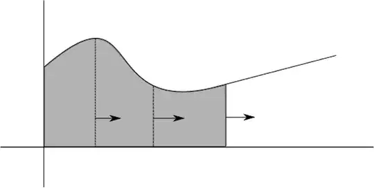

I'm sure some will have an issue with the technical aspects of the following explanation, but I believe that it should intuitively help.
One way to think about the area under a curve (and the definite integral), is to picture a vertical line from the horizontal axis to the graph of your function. Starting at say $x=0$, picture this line moving to the right. As it does, and its height changes, it will touch along the way a set of points in the plane (shaded below). Perhaps think about this line as being covered in paint, and as it moves along it paints the area under the curve. enter image description here
You can view the definite integral $$\int_0^xf(t)dt$$ as suggesting the motion of this line of changing height on the horizontal axis from 0 to $x$ and giving you the area of the region that it "paints".

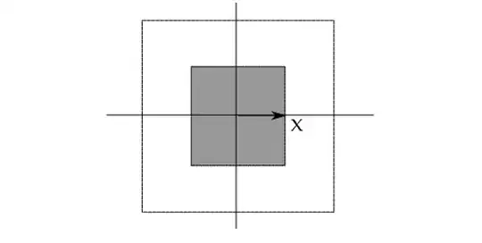

The same thought process works for other shapes. Consider a square centered at the origin. enter image description here
The perimeter of this square is $8x$. Think of $x$ starting at zero and increasing. As the square increases in size, its perimeter will also "paint" a collection of points in the plane, and we can think about the area of the square as being the painted points. In the same vein as above, the integral $$\int_0^x8tdt=4x^2$$ suggests the painting of these points and gives us the area of the resulting collection of painted points (you can easily see that $4x^2$ is the area of the shaded square).
