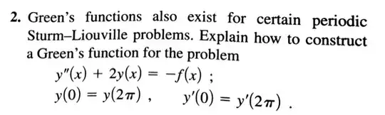

Background and motivation: I'm given the boundary value problem: $$y''(x)+2y(x)=-f(x)$$ subject $y(0)=y(2\pi)$ and $y \, '(0)=y \, '(2\pi)$.
EDIT: These were not given to be zero !! Maybe this helps...
The text (Nagle Saff and Snider, end of Chapter 11 technical writing exercise) asks us to construct the Green's function for the problem. At the moment, I'm a bit stumped because there is no $\lambda$ in the given problem. Let me elaborate, if we were given: $$ (py')'+qy+\lambda r y= 0 $$ where $p,p',q$ and $r$ were continuous, real-valued, periodic functions with period $2\pi$ then I think I'd be able to get started. I know the usual solutions then only fit the given boundary conditions for particular choices of $\lambda$. So, my initial observation is that $p=1$ is certainly continuous and periodic so we can set $p=1$.
  • Question: what should I see as $q$ and $r$ for the problem stated at the start of this post? How can we massage the given problem into the standard form of Sturm Liouville?
I suppose it is important to note we must choose $r>0$ as it serves as the weight function in the inner product which is paired with the eigenspace of solutions for this problem.
Added: here is a picture of the problem from the text: enter image description here

  • @rajb245 Hi, my student (who I'm posting this for) just noticed I wrote the problem down wrong.. there was no assumption of triviality, only equality of values and derivatives at the boundary. This is quite different. So sorry. – James S. Cook Apr 30 '14 at 20:47
  • Aha, that makes a little more sense. Thanks for the correction. – rajb245 Apr 30 '14 at 20:56
  • @rajb245 just added a picture of the problem from the text. – James S. Cook May 01 '14 at 03:01
