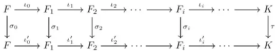

Here's a diagram I included, but I'm not sure how much that helps. enter image description here

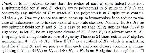

I agree with you that your theorem and proof prove more than one different and interesting results at the same time. That's why it's more natural to prove it from previous lemmas, such as the uniqueness up to isomorphism of algebraic closures, which is interesting in its own right.
For example, the following is taken from these field theory notes by Prof. Clark:
Your theorem is condition b.
Uniqueness of algebraic closures is not a trivial fact, as you already guessed, and it's usually proven using some form of the axiom of choice. And you actually need (some form of) choice, see remark 5.1.1 in Prof. Clark's notes.

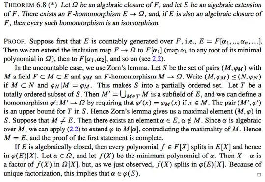

A proof using Zorn's lemma, as you prefer, can be found in Milne's Field Theory notes (or in theorem 24 in Prof. Clark's notes). Here it is:
