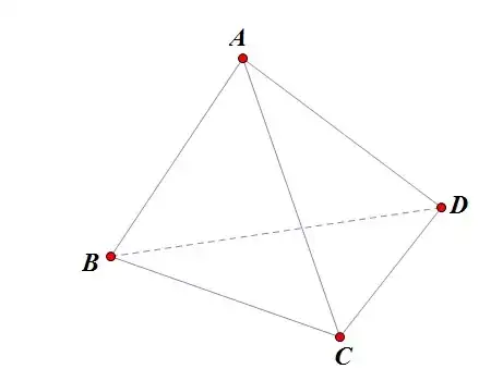

A tetrahedron $A-BCD$ is such all four faces are similar right triangle.
and we let $$AB=a,BC=b,AC=c,AD=d,BD=e,CD=f$$ define $$x=\max{(a,b,c,d,e,f)},y=\min{(a,b,c,d,e,f)}$$ show that: $$\dfrac{x}{y}=\sqrt{\dfrac{\sqrt{5}+1}{2}}$$
since $$\Delta Rt ABC\sim\Delta Rt ACD\sim\Delta Rt ABD\sim\Delta Rt BCD$$ Now we must suru which angle is right anlge,But I fell ugly,can you help me,and I think this is interesting problem.
it is said this problem have other solution $$\dfrac{x}{y}=\sqrt{2}?$$ this is true ? Thank you

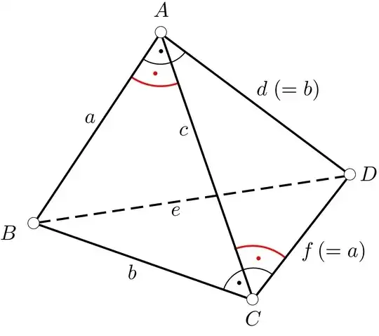

${\bf 1\ }$ Assume the side $BD=e$ (dashed in the figure) is a longest side of the tetrahedron. Then it has to be the hypotenuse of both adjacent triangles $ABD$ and $CBD$, so these two triangles have to be congruent.
${\bf 2\ } $ If $BA=BC$ then both triangles $BAC$ and $DAC$ are isosceles with hypotenuse $AC$. Claim: In this case the tetrahedron is flat, making up a square.
Proof. Assume the four points $A$, $B$, $C$, $D$ are not lying in a plane. Then there is exactly one sphere containing all four points. Therefore the two Thales spheres over $BD$ and $AC$ must coincide. It follows that $BD$ and $AC$ intersect in their midpoints, proving that our assumption is untenable.
${\bf 3\ }$ Therefore we may assume $a=BA=DC<BC=DA=b$, where $$a^2+b^2=e^2\ .\tag{1}$$ When triangle $BAC$ has its right angle at $B$ then necessarily $AC=e$, which enforces triangle $DAC$ to have its right angle at $D$, and it follows as in ${\bf 2\ }$ that the tetrahedron is flat, making up a rectangle.
${\bf 4\ }$ As $a<b$ it remains to consider the case that triangle $BAC$ has its right angle at $A$, and triangle $DAC$ has its right angle at $C$. $AC=c$ is then shortest side. It follows that $$b^2-a^2=c^2\ ,\tag{2}$$ and the similarity condition enforces $${a\over c}={b\over a}\ .\tag{3}$$
From $(1)-(3)$ we obtain after some computation $${e\over c}=\sqrt{2+\sqrt{5}}\ ,$$ which is almost what the OP claimed.
