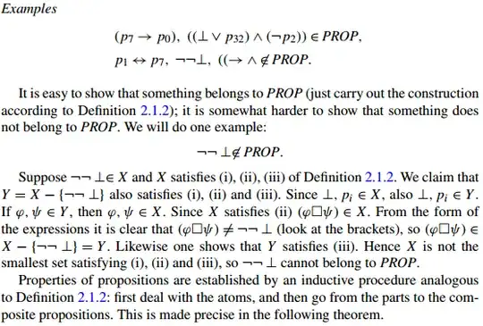

I'm reading Dalen's Logic and Structure.
He gives the definition of the set $PROP$:
Definition $\bf2.1.2$ The set $PROP$ of propositions is the smallest set $X$ with the properties
$\begin{array}{rl} \rm(i)&p_i\in X(i\in N),\bot\in X,\\ \rm(ii)&\varphi,\psi\in X\Rightarrow(\varphi\wedge\psi),(\varphi\vee\psi),(\varphi\to\psi),(\varphi\leftrightarrow\psi)\in X,\\ \rm(iii)&\varphi\in X\Rightarrow(\neg\varphi)\in X.\\ \end{array}$
Then there are some examples:
And he says that $¬¬\bot \not\in PROP$, but I don't understand it. Isn't $¬¬ \bot=\bot$ due to the property of double negation? Considering this is true, $\bot\in PROP$. Of course, in this question, I'm pressuposing some kind of evaluation, that $¬¬ \bot$ becomes $\bot$ due to the law of the double negation, but perhaps it should be hold in an unevaluated form.

As the author himself alerts to: look at the brackets. What's in $PROP$ is $\left(\neg \left(\neg\bot\right)\right)$ (note the two pairs of $()$).
It isn't true that $\neg \left(\neg \bot\right)=\neg \neg \bot$ simply because they aren't the same string of characters. In mathematical logic, particularly in formal systems, one looks at propositions as actual mathematical objects, more precisely as finite strings of characters. The second character in $\neg \left(\neg \bot\right)$ is $\color{blue}($ which differs from the second character in $\neg \neg \bot$. Therefore they are different.
It is likely that eventually, after some familiarity with these concepts has been acquired,that $\neg \neg \bot$ might be defined as $\left(\neg (\neg \bot)\right)$, but for now they are different. Not only that, as the author proves, $\neg \neg\bot \not \in PROP$ according to the formation rules.

    @IgäriaMnagarka Yes, you shouldn't interpret them.They are just symbols. They could have very well used $\huge ☺$ instead of $\neg$ and then you wouldn't have had this problem. – Git Gud Apr 10 '14 at 21:56

    @IgäriaMnagarka $(i)$ gives you $\bot \in X$, then in $(iii)$ replacing $\varphi$ with $\bot$ gives you $\bot \in X\implies (\neg\bot )\in X$, therefore $(\neg\bot)\in X$. Now using $(iii)$ again, this time with $\varphi=(\neg \bot)$ yields $(\neg \bot)\implies (\neg (\neg \bot))\in X$, therefore $(\neg (\neg \bot))\in X$. – Git Gud Apr 10 '14 at 23:19
    @IgäriaMnagarka More generally than Git Gud's last comment: Look at the definition of $PROP$ in the question. The only clause that lets you introduce a $\neg$, namely clause (iii), also requires you to introduce a pair of parentheses. – Andreas Blass Apr 10 '14 at 23:24
  • Yes. Thanks guys! – Red Banana Apr 10 '14 at 23:26
    This all said if the author had defined PROP with iii as "if $\phi$ belongs to PROP, then ¬$\phi$ belongs to PROP" no ambiguities similar to how ambiguities would occur if you dropped the parentheses in the second clause. Also, in that case ¬¬⊥ would belong to PROP, but (¬(¬(⊥)) would not belong to PROP. – Doug Spoonwood Apr 11 '14 at 04:07
