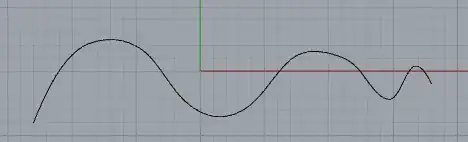

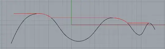

I know you already accepted an answer, but nothing does it like a picture for me. Imagine our sequence does something like this where $n$ increases in the positive $x$ direction.a fluctuating sequence.
Then the limsup of this sequence would be the redline (not the axis).
The top of the peaks is red but only on one side with a horizontal line extending to the next peak.

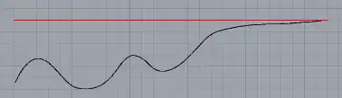

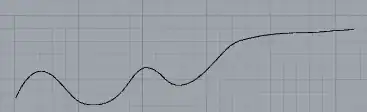

But if the sequence looks like this,
a sequence that is eventually monotone increasing
our limsup will do this.
a red line that is horizontal and at the top of the sequence
