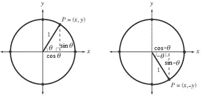

Why $\cos(-\theta)$ gives positive values while in case of sine it is negative?
I mean
$\cos(-\theta) = +\cos(\theta)$
$\sin(-\theta) = -\sin(\theta)$
$\tan(-\theta) = -\tan(\theta)$
and please explain General Angles in simple worlds?

Changing the sign of $\theta$ corresponds to going around in the other direction. Because $\theta$ is measured from the positive $x$-axis, all this does is to flip the endpoint over the $x$-axis, as shown below.
Since cosine is the $x$-component of $P$, and sine is the $y$ component, flipping over the $x$-axis will negate $\sin \theta$, but not $\cos \theta$. Hopefully this makes it clear why sine and cosine behave the way they do.
With tangent, just recall that $\tan \theta = \frac{\sin \theta }{\cos \theta }$, and since only one part of the fraction gets a $-$ sign, the tangent gets one as well.
Henry Swanson
  • 13,278
  • From figure 2, sin(-90) should be 1. As both perpendicular and hypotenuse are -y. Am I missing something? – q126y Aug 26 '17 at 03:39
  • I guess technically I should have denoted the old point as $P = (a,b)$, and the other one as $P' = (a, -b)$. In the case you're thinking of, $\theta = 90$, do you see how this makes $\sin (-90) = -1$? – Henry Swanson Aug 26 '17 at 03:53
  • in second case, sin(-90) = OP'/OP' = -b/-b = 1 – q126y Aug 26 '17 at 05:02
  • Mr. Henry, what is wrong with my reasoning? Thanks. – q126y Dec 13 '18 at 06:34
    If P = (0,-1), i.e., θ = -90°, then the opposite is -1, and the hypotenuse is 1 (it always is; we're on the unit circle). So sin(-90°) = -1. – Henry Swanson Dec 13 '18 at 06:44

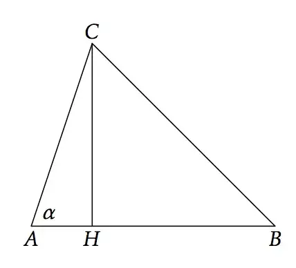

Trigonometric functions were introduced to do computations about triangles. Consider the following picture:
cosine law 1
and set $a=BC$, $b=AC$, $c=AB$. Set also $h=CH$ and $d=AH$. Then you can say $$ b^2=d^2+h^2,\qquad a^2=(c-d)^2+h^2. $$ If we subtract the two equalities, we get $$ b^2-a^2=d^2-(c-d)^2=-c^2+2cd $$ or $$ a^2=b^2+c^2-2cd. $$ But now, by definition, $d=b\cos\alpha$, so we obtain the cosine law for acute angles.

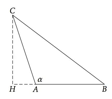

In ancient times sines and cosines were not attributed a “sign”; they were just defined with ratios using right triangles, so they made sense only for acute angles. For an obtuse triangle the figure is
Cosine law 2
With the same notation as before, we get the relations $$ b^2=d^2+h^2,\qquad a^2=(c+d)^2+h^2 $$ and subtracting gives $$ b^2-a^2=d^2-(c+d)^2=-c^2-2cd $$ or $$ a^2=b^2+c^2+2cd. $$ Now, if $\bar\alpha$ denotes the supplementary angle of $\alpha$, we can write the cosine law for obtuse triangles: $$ a^2=b^2+c^2+2bc\cos\bar\alpha. $$ When negative numbers became less suspicious, people started to realize that one could define the cosine of an obtuse angle as the negative of the cosine of the supplementary angle, so that only one cosine law could be written: $$ a^2=b^2+c^2-2bc\cos\alpha. $$ A similar reasoning based on the sine law makes it clear that the sine of an obtuse angle should be the same as the sine of the supplementary angle.
cosine law 1
Cosine law 2
Sines and cosines were later defined for any angle; the extension can be justified with the trigonometric circle and it became clear that one had to define them so that $$ \sin(-\alpha)=-\sin\alpha,\qquad \cos(-\alpha)=\cos\alpha $$ just by looking at the trigonometric circle.
