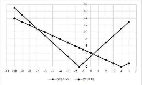

Let's solve it graphically.
Draw the graphs of $y_1=|3+2x|$ and $y_2=|4-x|$ and find the interval where $y_2\ge y_1$.
The graphs intersect at:
$$3+2x=4-x\Rightarrow x=\frac 13$$ and $$3+2x=x-4 \Rightarrow x=-7$$
Referring to the graph below, we find the solution:
