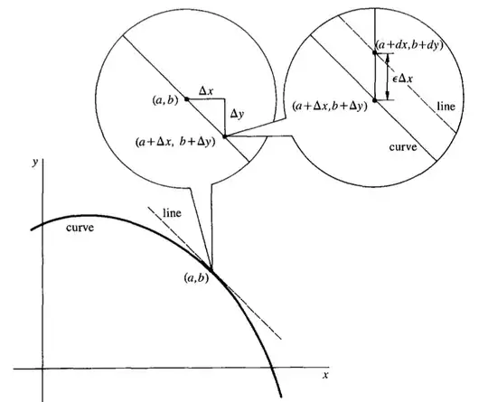

First, the $u$-substitution, while used in integration, is on its own an operation of differentiation. As differentiation is a function (on functions), and both sides are equal, the differentials must be equal. It is by definition of any function that $a=b\Rightarrow f(a)=f(b)$.
So, what is differentiation? It is the infinitesimal variation of the tangent of a function on a point. What you might be thinking is: why make a distinction between the variation on the tangent and on the function itself if they're coincident when zooming in enough? The answer is this allows us to both define the derivative as a (hyper)real fraction (pun intended), and not simply and informally discard the smaller infinitesimals.
An accurate image to illustrate this is the following taken from the book:
https://i.sstatic.net/OqYKE.png
As the differential is on the tangent, and to know the tangent one should know the derivative, the former's definition is $dy = f'(x)\ dx$. Note everything here are numbers, and by the transfer principal, usual rules of algebra apply.
