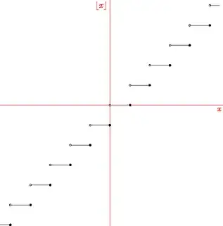

  2. Look at the function floor(x) which is defined as the highest integer that is less than equal to x. Here is the graph :
The limit on 1 does not properly exist. There is a right-sided limit which is 1 and the value of f in 1. However the left-sided limit in 1 is 0 and is not the value of f in 1.
