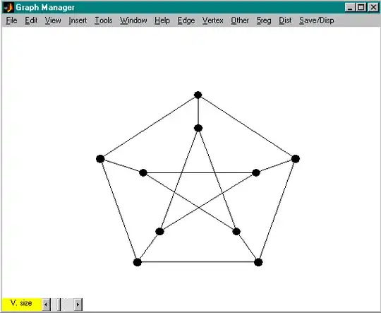

I wrote some software in Matlab for this task for my own purposes, and it is available for download from my website: Graph Manager. It was designed to work with Matlab 6.5 (the only version I own which was released over 10 years ago) and you should unzip it and run it with graphm from inside the created directory. It should look like this:
graphm1
You can use the mouse to add/delete vertices and edges and do other things. Since it was for my use there are probably a few things that are unclear, feel free to ask here if there is a problem.
Since it was mainly used to look at graphs on the torus you will need to switch that off if you see the green box; you do that with "Save/Disp" and the "shape" submenu. To get the adjacency matrix you can just go to the main Matlab window and it will be in the global variable A.

  • Excuse me, two days I was out of station and could not check this post. I have downloaded it. I shall contact you latter. Thank you. – Supriyo Apr 07 '14 at 06:22
  • The last paragraph is not clear. How to access "Miscellaneous" ? – Supriyo Apr 07 '14 at 09:13
  • Sorry, I just realised that version 1 is the one on the website. It should be simpler for your use. I've adjusted the instructions about how to get the adjacency matrix now. – jp26 Apr 07 '14 at 13:02
  • Dear Sir, Thank you very much for your help. I am very new with MATLAB and the graph theory... – Supriyo Apr 08 '14 at 04:57
  • +1 I've searched too long for something like that. Is there a manual? Oh I just realized that I can't upvote today, since I reached my daily limit... – draks ... Jul 07 '14 at 21:12
  • Sorry, no manual, but if there's something that doesn't do what you think, feel free to ask here. – jp26 Jul 08 '14 at 00:15
  • @jp26 are there any key shortcuts? And does it support an algorithm to color the edge? – draks ... Jul 08 '14 at 07:19
  • There are shortcuts using the underlined letters, so alt V to get to the vertex menu, etc. I've never needed edge colouring, so didn't implement it, sorry. It should be possible to add it with a bit of coding knowledge though. – jp26 Jul 08 '14 at 10:04
