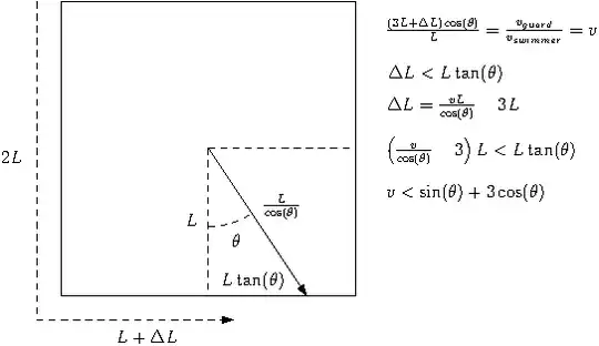

I don't think it's as easy as some are making it out to be. First draw a sketch, it is obvious that you should go in one of two directions. In my sketch, that's either downward (the way I drew) or rightward (going towards the right edge of the square). Both of those will produce the same result (it's symmetrical).
The time it takes to get to the side is proportional to the length ($t = \frac{1}{v}d$). The prisoner should go at a certain angle (again look at my sketch), $\theta$. This gives the length to the side (the hypotenuse) as:
$$ l_{swimmer} = \frac{L}{\cos(\theta)} $$
where $L$ is half the length of the square and $\theta$ ranges from $0$ to $\frac{\pi}{4}$ radians ($\theta = 0$ means going straight down and $\theta = \frac{\pi}{4}$ means going towards the opposite corner).
Now, the length that the guard has to run is given by $3L + L\tan(\theta)$ ($2L$ from going down one full side, $L$, from going to the right half way, and then finally the extra length from the prisoner swimming at a diagonal).

A Simpler Explanation
It is clear from the above picture that the largest possible $v$ value comes when $\sin(\theta) + 3\cos(\theta)$ achieves its maximum value--its amplitude: $v_{max} = \sqrt{1^2 + 3^2} = \sqrt{10}$. We can find this value $\theta_C$ by either rewriting $\sin(\theta) + 3\cos(\theta) = \sqrt{10}\cos(\theta - \theta_C)$ or by simply finding critical points from the derivative:
$$ f'(\theta) = \cos(\theta) - 3\sin(\theta) \\ \frac{\sin(\theta_C)}{\cos(\theta_C)} = \tan(\theta_C) = \frac{1}{3} $$
This is not a special right triangle so simply find:
$$ \theta_C = \tan^{-1}\left(\frac{1}{3}\right) \approx 18.43^\circ $$
Note that it's important that $\theta_C$ fall between $-45^\circ$ and $+45^\circ$ since these are the only angles where our figure is valid.
