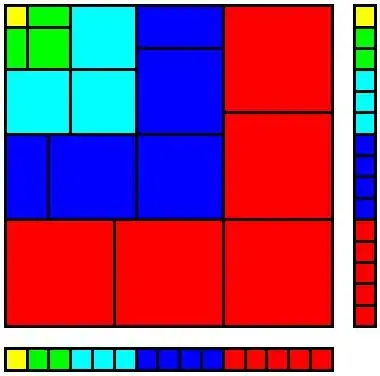

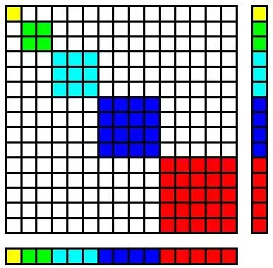

How about the proof that
$$1^3+2^3+\cdots+n^3=\left(1+2+\cdots+n\right)^2$$
I remember being impressed by this identity and the proof can be given in a picture:
The picture is taken from Brian Sears' webpage. See also here.
Edit: Substituted $\frac{n(n+1)}{2}=1+2+\cdots+n$ in response to comments.
- 4,000
- 18,312
41
9I've no idea what the strips to the left and right are for. But, aside from that, the first diagram shows squares of length 1, 2, 3, ..., $n$. The second diagram shows one $1\times1$ square, two $2\times 2$ squares, three $3\times3$ squares and so on; it's easy to see how to generalize the diagram up to $n$ $n\times n$ squares, which shows an area of $1^3+2^3+3^3+\dots+n^3$, arranged in an area of $(1+2+\dots+n)^2 = (\tfrac12n(n+1))^2$. – David Richerby Mar 26 '14 at 23:22
11The strips at bottom and right illustrate how the grid pictured is $(1+2+\cdots+n)^2$. The bottom picture shows, for each $n$, $n$ squares (for even $n$ one of these squares is cut in half), each square $n\times n$; thus, for instance, the total light-blue area is $3\times (3\times 3) = 3^3$ and the total area is $1^3+2^3+\cdots+n^3$. – Steven Stadnicki Mar 27 '14 at 00:39
This is a stretch for the intended audience. Note that a number of people here are having trouble connecting the pictures with the result. It's unintelligible to anyone who doesn't already know that 1+...+n = n(n+1)/2. It's also hard to appreciate the second diagram without understanding induction. Besides that, the result itself may not be interesting enough for the target audience to pay close attention. (the sum of these numbers cubed is the square of the sum of the numbers themselves! ... uh, what? ... Look at this diagram! ... uh, OK). That said, it's new to me and I like it! – ColinK Mar 27 '14 at 12:12
@ColinK: "It's unintelligible to anyone who doesn't already know that 1+...+n = n(n+1)/2". The intended audience is first year university students. Without wishing to get into an argument about the content of school mathematics curricula, surely this should be a familiar result by the end of that year even if it isn't at the start? That said, if this proof is intended to be as beautiful as possible then it needs a different colour scheme ;-) – Steve Jessop Mar 27 '14 at 12:25
@SteveJessop: This is reaching a bit in my memory, but I don't think that I personally had even seen summation notation until a 2nd year discrete math course. Why would such a result be known by students in Calc 1/2 or in high school? (Good edit on the answer!) – ColinK Mar 27 '14 at 13:50
2@ColinK: I don't know about US or CA high school curricula, which is part of the reason I can't argue about them ;-) I'm certain we proved $n(n+1)/2$ by drawing pictures and also by induction in high school in the UK. I've also just found a summation symbol on one of my end-of-first-year examination papers, on a question about the radius of convergence of $\sum a_n x^n$. I've said elsewhere though, it may be that regional differences in the degree of specialization of first-year university students means that this question has no baseline. – Steve Jessop Mar 27 '14 at 14:13
1... UK university studies are extremely specialized. I studied literally only mathematics and no other subject from day 1 of my degree for 4 years resulting in a master's. There were some topics that arguably are computer science or physics as well as being maths, and students can study multiple subjects in certain combinations (although I didn't). But basically if you're a maths student you're studying only maths, and so of course you'd see results like that quite soon. – Steve Jessop Mar 27 '14 at 14:28
1Wow, this one is amazing. It took me a couple of minutes to study the formula and the pictures and figure it out, but yeah, that's an elegant proof. – Ryan Mar 27 '14 at 17:29
1I think the confusion is also partly based on trying to work out what the white space represents, it sort of looks like something might be being added or subtracted but is actually just an unnatural representation of
(1 + 2 + ... + n)^2. There must be a clearer way to draw that... – Chris Burt-Brown Mar 28 '14 at 10:33

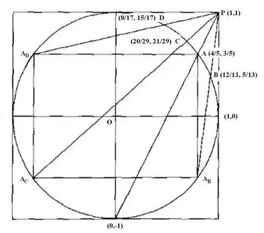

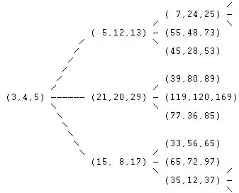

One little-known gem at the intersection of geometry and number theory is Aubry's reflective generation of primitive Pythagorean triples, i.e. coprime naturals $\,(x,y,z)\,$with $\,x^2 + y^2 = z^2.\,$ Dividing by $\,z^2$ yields $\,(x/z)^2+(y/z)^2 = 1,\,$ so each triple corresponds to a rational point $(x/z,\,y/z)$ on the unit circle. Aubry showed that we can generate all such triples by a very simple geometrical process. Start with the trivial point $(0,-1)$. Draw a line to the point $\,P = (1,1).\,$ It intersects the circle in the rational point $\,A = (4/5,3/5)\,$ yielding the triple $\,(3,4,5).\,$ Next reflect the point $\,A\,$ into the other quadrants by taking all possible signs of each component, i.e. $\,(\pm4/5,\pm3/5),\,$ yielding the inscribed rectangle below. As before, the line through $\,A_B = (-4/5,-3/5)\,$ and $P$ intersects the circle in $\,B = (12/13, 5/13),\,$ yielding the triple $\,(12,5,13).\,$ Similarly the points $\,A_C,\, A_D\,$ yield the triples $\,(20,21,29)\,$ and $\,(8,15,17),\,$
We can iterate this process with the new points $\,B,C,D\,$ doing the same we did for $\,A,\,$ obtaining further triples. Iterating this process generates the primitive triples as a ternary tree
$\qquad\qquad$
Descent in the tree is given by the formula
$$\begin{eqnarray} (x,y,z)\,\mapsto &&(x,y,z)-2(x\!+\!y\!-\!z)\,(1,1,1)\\ = &&(-x-2y+2z,\,-2x-y+2z,\,-2x-2y+3z)\end{eqnarray}$$
e.g. $\ (12,5,13)\mapsto (12,5,13)-8(1,1,1) = (-3,4,5),\ $ yielding $\,(4/5,3/5)\,$ when reflected into the first quadrant.
Ascent in the tree by inverting this map, combined with trivial sign-changing reflections:
$\quad\quad (-3,+4,5) \mapsto (-3,+4,5) - 2 \; (-3+4-5) \; (1,1,1) = ( 5,12,13)$
$\quad\quad (-3,-4,5) \mapsto (-3,-4,5) - 2 \; (-3-4-5) \; (1,1,1) = (21,20,29)$
$\quad\quad (+3,-4,5) \mapsto (+3,-4,5) - 2 \; (+3-4-5) \; (1,1,1) = (15,8,17)$
See my MathOverflow post for further discussion, including generalizations and references.

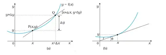

The derivation of first principle of differentiation is so amazing, easy, useful and simply outstanding in all aspects. I put it here:
Suppose we have a quantity $y$ whose value depends upon a single variable $x$, and is expressed by an equation defining $y$ as some specific function of $x$. This is represented as:
$y=f(x)$
This relationship can be visualized by drawing a graph of function $y = f (x)$ regarding $y$ and $x$ as Cartesian coordinates, as shown in Figure(a).
Consider the point $P$ on the curve $y = f (x)$ whose coordinates are $(x, y)$ and another point $Q$ where coordinates are $(x + Δx, y + Δy)$.
The slope of the line joining $P$ and $Q$ is given by:
$tanθ = \frac{Δy}{Δx} = \frac{(y + Δy ) − y}{Δx}$
Suppose now that the point $Q$ moves along the curve towards $P$.
In this process, $Δy$ and $Δx$ decrease and approach zero; though their ratio $\frac{Δy}{Δx}$ will not necessarily vanish.
What happens to the line $PQ$ as $Δy→0$, $Δx→0$? You can see that this line becomes a tangent to the curve at point $P$ as shown in Figure(b). This means that $tan θ$ approaches the slope of the tangent at $P$, denoted by $m$:
$m=lim_{Δx→0} \frac{Δy}{Δx} = lim_{Δx→0} \frac{(y+Δy)-y}{Δx}$
The limit of the ratio $Δy/Δx$ as $Δx$ approaches zero is called the derivative of $y$ with respect to $x$ and is written as $dy/dx$.
It represents the slope of the tangent line to the curve $y=f(x)$ at the point $(x, y)$.
Since $y = f (x)$ and $y + Δy = f (x + Δx)$, we can write the definition of the derivative as:
$\frac{dy}{dx}=\frac{d{f(x)}}{dx} = lim_{x→0} [\frac{f(x+Δx)-f(x)}{Δx}]$,
which is the required formula.
