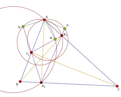

Let $ABC$ be a triangle of any type and $A_1,B_1,C_1$ the feet of the heights. Denote $M,N,P$ the orthogonal projections of the point $A$ onto the lines $B_1C_1,C_1A_1$ and $A_1B_1$. The circes $AMA_1,ANB_1$ and $APC_1$ have two common points from my figure. The proof seems not too easy, any help would be appreciated!

  • "The feet of the heights"...which can be on the opposite sides or on their continuations if the triangle's an obtuse one... – DonAntonio Mar 24 '14 at 17:14
  • yes, and what is wrong? – user137654 Mar 24 '14 at 17:17
    Oh, nothing at all...just that you didn't specify where the feet are, assuming perhaps what I wrote above. Perhaps a diagram could greatly help here...as in most other geometry questions. – DonAntonio Mar 24 '14 at 17:18
  • I've verified this with coordinates, but I'm looking for a more-elegant solution. – Blue Mar 24 '14 at 17:56
    You can show me your solution with coordinates. It's nice to see a non-synthetic solution. – user137654 Mar 24 '14 at 18:06
  • @user137654: The coordinate solution is far too cumbersome to write-up at the moment. – Blue Mar 24 '14 at 18:11
  • When there's a right angle at $B$ or $C$, the three circles coincide, so there's not a unique "second point" (other than $A$) on them. When there's a right angle at $A$, two of the circles become point-circles at $A$, so there's no "second point" at all. – Blue Mar 24 '14 at 19:04

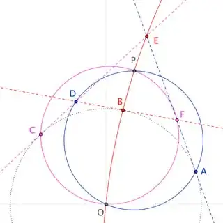

  • The problem can be re-cast like this: Consider $M$, $N$, $P$ on a circle centered at $A$. Let $D$ be the point where the tangents at $N$ and $P$ meet; likewise, $E$ is where tangents at $P$ and $M$ meet, and $F$ is where tangents at $M$ and $N$ meet. ($D$, $E$, $F$ are the question's $A_1$, $B_1$, $C_1$.) Show that $\bigcirc AMD$, $\bigcirc ANE$, $\bigcirc APF$ contain a common point other than $A$. This, too, can be proven coordinate-wise by showing that the intersection of two circles is symmetric in the parameters defining all three points $M$, $N$, $P$. The derivation remains cumbersome. – Blue Mar 25 '14 at 11:17
I'll leave it as a fairly-straightforward exercise for the reader to show that $\bigcirc MNP$ is an excircle of $\triangle A_1B_1C_1$, and that it has center $A$. The result in the question then follows from the claim below, which one would apply to excircle $\bigcirc MNP$.
Note that the notation in the claim is independent of that in the question. Also, the claim is proven for distinct points on a circle; this corresponds to the requirement of distinct $M$, $N$, $P$ in the original question.
Claim. Given distinct $A$, $B$, $C$ on $\bigcirc O$, let $D$ be the point where the tangent lines to $\bigcirc O$ at $B$ and $C$ meet; likewise, let $E$ be the point there the tangents at $C$ and $A$ meet, and let $F$ be the point where the tangents at $A$ and $B$ meet. Then $\bigcirc OAD$, $\bigcirc OBE$, $\bigcirc OCF$ share two points ($O$ and, say, $P$).
For proof, we may take $\bigcirc O$ to be the unit circle, and give our points coordinates $$A = \operatorname{cis}(2\alpha) \qquad B = \operatorname{cis}(2\beta) \qquad C = \operatorname{cis}(2\gamma)$$ where I'm abusing notation to write "$\operatorname{cis}\theta$" for "$(\cos\theta, \sin\theta)$". Then, since $\angle DOB = \angle DOC = |\beta-\gamma|$ and $|OB|/|OD| = \cos(\beta-\gamma)$, we have $$D = \frac{\operatorname{cis}(\beta+\gamma)}{\cos(\beta-\gamma)} \quad E = \frac{\operatorname{cis}(\gamma+\alpha)}{\cos(\gamma-\alpha)} \quad F = \frac{\operatorname{cis}(\alpha+\beta)}{\cos(\alpha-\beta)}$$
As $\bigcirc OAD$ passes through the origin, its equation has form $x^2+y^2-2 h x - 2 k y = 0$, where $(h,k)$ is its center. Substituting $A$ and $D$ gives a linear system in $h$ and $k$ that we can solve, giving the circle equation: $$x^2 + y^2 - x\frac{2\sin2\alpha-\sin2\beta-\sin2\gamma}{2\sin(2\alpha-\beta-\gamma)\cos(\beta-\gamma)} + y \frac{2\cos2\alpha-\cos2\beta-\cos2\gamma}{2\sin(2\alpha-\beta-\gamma)\cos(\beta-\gamma)} = 0$$ The equations for $\bigcirc OBE$ and $\bigcirc OCF$ arise from cycling the parameters $\alpha \to \beta \to \gamma \to \alpha$. Taking any two of these circles, we can determine their points of intersection; one of them is, of course, $O$. The other is $$P := \frac{3 \; \left( \; \cos2\alpha + \cos2\beta + \cos2\gamma \;,\; \sin2\alpha + \sin2\beta + \sin2\gamma \; \right)}{3+2\cos2(\beta-\gamma)+2\cos2(\gamma-\alpha)+2\cos2(\alpha-\beta)}$$
Because the coordinates are symmetric in $\alpha$, $\beta$, $\gamma$, we are assured that $P$ lies on the third circle, as well, proving the claim.
Interestingly, as the coordinates of $P$ have the form $m \;(A + B + C )$, we find that $O$, $P$, and the centroid of $\triangle ABC$ are collinear.
