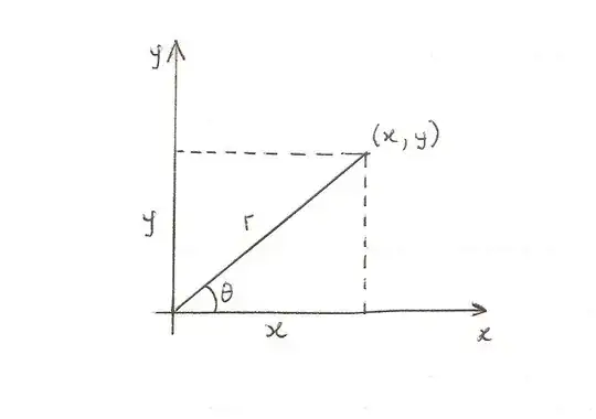

It is the $y=f(x)$ expression of the curve in the $x,y$ referential (see picture). It can also be the implicit form $F(x,y)=F(x,f(x))\equiv 0$.
Steps:
1) transformation of polar into rectangular coordinates (also known as Cartesian coordinates) (see picture)
$$x=r\cos \theta ,$$
$$y=r\sin \theta ;$$
2) from trigonometry and from 1) $r=\sqrt{x^2+y^2}$
$$\sin \theta =\frac{y}{r}=\frac{y}{\sqrt{ x^{2}+y^{2}}};$$

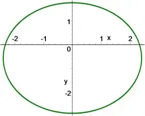

As commented by J.M. the curve is an ellipse. Here is the plot I got using the equation $16y^{2}+18y+15x^{2}-81=0$.
  • As a check: the original polar equation is in fact that of a conic with focus at the origin. Rewriting the expression as $r=\dfrac{\frac94}{1+\frac14\sin,\theta}$, we find that we have an ellipse with eccentricity $\frac14$. The same result can be seen if we use completing the square to convert the Cartesian equation to a standard form and compute the eccentricity from the values of the semimajor and smiminor axes... – J. M. ain't a mathematician Oct 13 '11 at 11:09
  • @J.M. Thanks! I added a picture. – Américo Tavares Oct 13 '11 at 11:29
