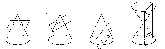

There are a few different ways of interpreting the relations between $\cos/\sin$ and $\cosh/\sinh$.
First, $\sin$ and $\cos$ parametrise the unit circle as follows: If we let $\theta$ be some anticlockwise angle from the positive real axis, if $x=\cos\theta$ and $y=\sin\theta$, then $(x,y)$ traces out a circle as $\theta$ varies. If, similarly, we let $x=\cosh t$ and $y= \sinh t$ then $(x,y)$ traces out a hyperbola (hence the name 'hyperbolic'). These may not seem immediately related, but it is known that they are both conic sections - that is, if we intersect a plane with a cone then we get a circle when the plane is horizontal, and a hyperbola when the plane is vertical. In the figure, the circle is on the left, and the hyperbola is on the right. enter image description here There are lots of other ways they are related. For example, consider the following identity: $$\cos^{2}\theta+\sin^{2}\theta=1$$ There is a similar result for the hyperbolic functions, namely $$\cosh^{2}t-\sinh^{2}t=1$$
Indeed, we can also relate them using the exponential function, viz. $$e^{i\theta}=\cos\theta+i\sin\theta \quad e^{t}=\cosh t+\sinh t$$
