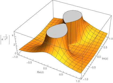

3D plot of magnitude

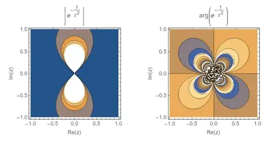

Abs/Arg plot pair
(I spent some time trying to clean up what amounts to random moire pattern in the center of the argument plot. The best I could manage follows, but is misleading about the violent flailing of the complex angle near the origin.)

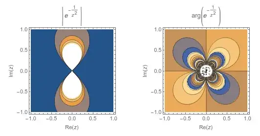

Another Abs/Arg plot pair
(What we should really be seeing is infinitely many thinner and thinner strips as we get closer to the origin. Of course, the strips are already one pixel wide in the given image -- if we attempt to thin them further, all we render is a continuous blob of contour lines.)
