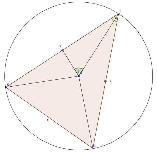

I thought an image could help: enter image description here
The perimeter is $$\overline{BC} + 2\overline{AB} = 2\sin \alpha + 2\cdot 2\sin \beta = 2\sin \alpha + 2\cdot 2\sin \left(\frac{\pi}{2} - \frac{\alpha}{2}\right) = 2\left(\sin \alpha+2\cos\left(\frac{\alpha}{2} \right) \right)$$ For further simplifications let $\alpha = 2t$, then you have to maximize $$f(t) = 2\left(\sin 2t+2\cos t) \right) = 2(2\sin t \cos t + 2\cos t ) = 4(\sin t \cos t + \cos t) $$ Finding $f'(t)$ is easy: $f'(t) = 4(\cos t \cdot \cos t + \sin t \cdot -\sin t -\sin t) = 4(\cos^2 t - \sin^2 t -\sin t )=4(-2\sin^2 t -\sin t +1)$ and it equals $0$ when $\sin t = \frac12 \Rightarrow t = \frac{\pi}{6} \Rightarrow \alpha = 2t = \frac{\pi}{3} $ so the triangle is equilater!
