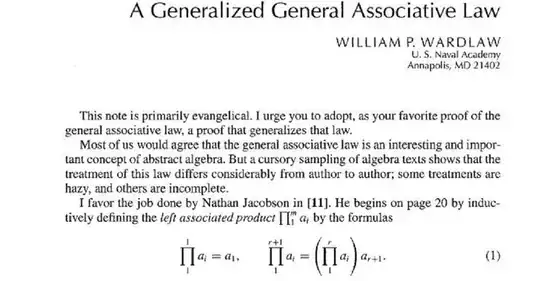

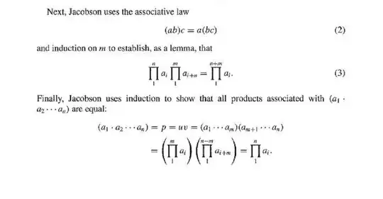

Also I have found this paper by William P. Wardlow - A generalized general associative law- that contains different proofs of this general associativity law. The first one, the one that he suggests as his favorite, is done by Nathan Jacobson in his book "Lectures of Abstract Algebra" Vol. 1 page 20. Looking at this proof there is one point where he says "Consider now any product associated with $(a_1, a_2,..., a_n)$...", which means "any bracketing associated with...". Then again the same question.

I should also say that a few good algebra texts prove "general associativity" formalized according to the First way I sketched above, or in similar veins. See, for instance, Theorem 2 in §I.1 of Claude Chevalley, Fundamental Concepts of Algebra, 1956, which gives a slightly stronger version of the First way.

The standard form in the definition is (or can be taken to be) Wardlaw’s left associative product, $$\left(\dots\left(\left(a_1\cdot a_2\right)\cdot a_3\right)\dots\cdot a_k\right),$$
which is the element of $A$ obtained by finding $a_1\cdot a_2$, multiplying it by $a_3$, and so on, up to a final product with $a_k$.
