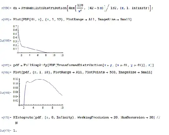

In addition to Henning's answer, here is a continuous distribution example of unimodal density such the sum is not unimodal: $$ f_X(x) = \frac{1}{182} \max\left( \frac{128}{x^2}, 42 - 5x \right) \mathbf{1}_{x \ge 1} $$
The density $f_{X+Y}(z)$ is unsightly, so its explicit form is suppressed in the snapshot.

Nice work. This counterexample also (almost) demonstrates that something like "smooth with exactly two inflection points" would not be a sufficient condition either. – hmakholm left over Monica Oct 07 '11 at 20:23
