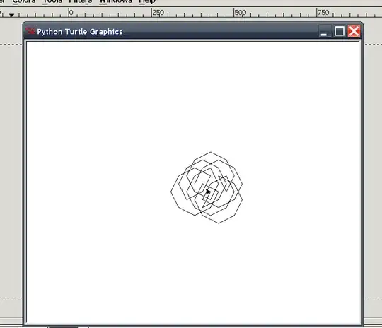

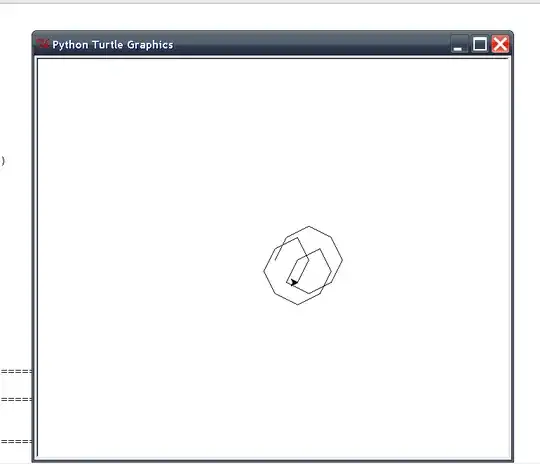

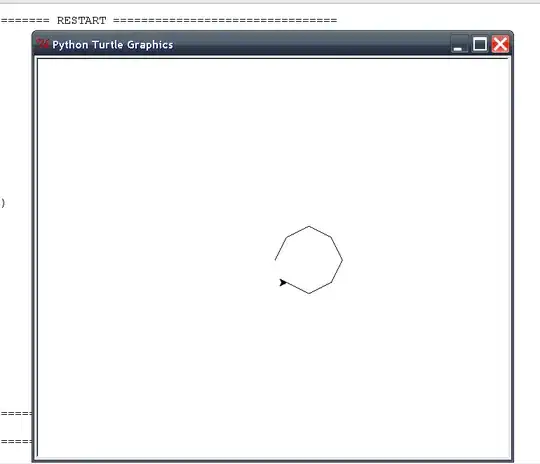

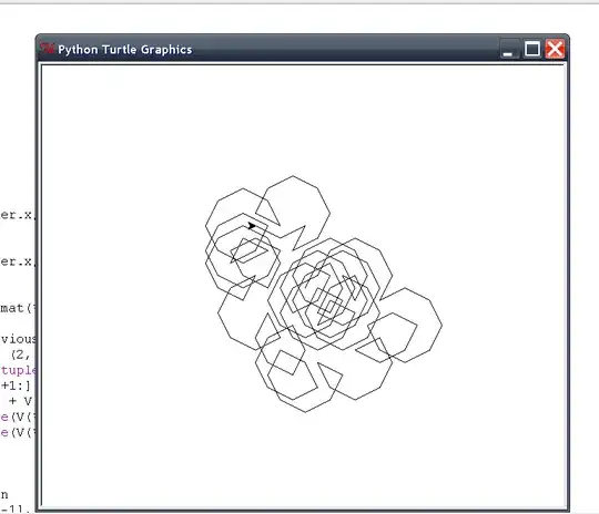

I discovered an automaton that produced interesting, random-seeming patterns.
The rule was as follows. Given a grid of points, some occupied and some not, and a current point and a previous point; change the current point to the unoccupied point one knight's move (two steps in one direction and one in the other) clockwise from the previous jump (or two if that point is occupied, or three, and so on). Then change the previous point to the old current point, and add the current point to the set of occupied points.
Here are some pictures of the automaton at various stages with no points initially occupied:
First picture Second picture Third picture Fourth picture

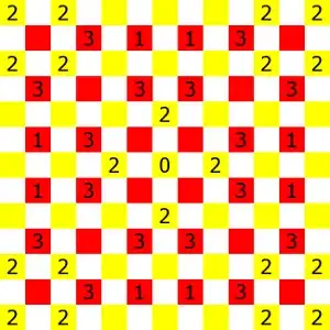

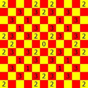

To begin, see the following two images which display $S(3,2)$ and $S(5,1)$
3,2
5,1
The numbers show the possible positions after n moves. The yellow squares are ones which may contain even numbers and the red squares are those that contain odd numbers. It can be seen that the checkerboard pattern shown in $S(3,2)$ is one which will apply for any x,y such that x-y is odd, while the pattern below applies when x-y is even. Given this, these patterns and their properties are extensible beyond the example given.
Notice how the two grids are equivalent to each other rotated 45° (by, for example, taking any every other diagonal of the second and mapping it to a row in the first). Indeed, when applying a 45° rotation on $(x,y)$ we obtain
$x' = x\cos(45) - y\sin(45)=\frac{x}{\sqrt2} - \frac{y}{\sqrt2}\\ y' = x\sin(45) + y\cos(45)=\frac{x}{\sqrt2} + \frac{y}{\sqrt2}$
and when normalizing to integers by multiplying by $\sqrt{2}$ (maintaining the 45° difference)
$x',y' = x-y,x+y$
(they may appear switched, but it is clear that $S(x,y) = S(y,x)$)
This demonstrates the symmetry these movements have over rotations of 45°, in particular that the movements of $S(x+y,x-y)$ can be 'simplified' to the movements of $S(x,y)$. This took me a bit of thinking and sketching out but the reason behind why it works is really quite elegant. In addition to the obvious symmetries the movements possess over scaling, reflecting, and rotating by 90°, there is a more subtle symmetry over 45° rotation.
