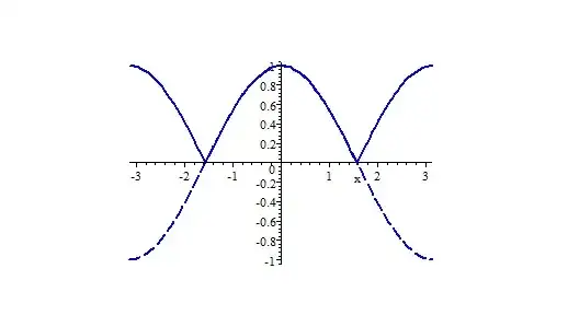

We can evaluate it as follows, as can be seen in the plot below
$$a_0 = \frac 1 \pi \int_{-\pi}^\pi |\cos(x)|\,dx=\frac 2 \pi \int_0^\pi |\cos(x)|\,dx=\frac 4 \pi \int_0^{\pi/2} |\cos(x)|\,dx = \frac 4 \pi \int_0^{\pi/2} \cos(x)\,dx=\frac 4 \pi.$$ $$\tag{1}$$
Plot of $\cos x$ (doted line) and $|\cos x|$ (solid line) in the interval $[-\pi,\pi]$.

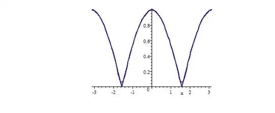

$$|\sin(x)|\ \text{(blue) and the partial sum }\frac{2}{\pi }+\frac{4}{\pi } \sum_{m=1}^{5 }\frac{(-1)^{m}}{1-4m^{2}}\cos (2mx) \ \text{(red) in }[-\pi,\pi]$$
Setting $x=0$ in $(5)$, we obtain
\begin{equation*} 1=\frac{2}{\pi }+\frac{4}{\pi }\sum_{m=1}^{\infty }\frac{(-1)^{m}}{1-4m^{2}}=\frac{2}{\pi }-\frac{4}{\pi }\sum_{n=1}^{\infty }\frac{(-1)^{n-1}}{1-4n^{2}}.\tag{6} \end{equation*}
Hence
\begin{equation*} \sum_{n=1}^{\infty }\frac{(-1)^{n-1}}{1-4n^{2}}=\frac{1}{2}-\frac{\pi }{4}.\tag{7} \end{equation*}
