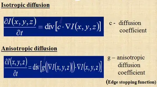

I have also asked a related question: https://dsp.stackexchange.com/questions/14606/anisotropic-diffusion. I couldn't understand the mathematics in it, but I roughly understood the theory. I need to understand the mathematics for the implementation.
I am trying to understand the equations in the above link: can you explain what can be concluded from these equations? How do they differ from each other?

What your first equation says is that $$ \frac{\partial}{\partial t}I=c\Delta I $$ If $c\gt0$ then the diffusion is working to fill in depressions and tear down accumulations. If $c\lt0$, the diffusion has the opposite effect.
The isotropic diffusion acts the same (constant $c$) everywhere, whereas the anisotropic diffusion acts differently depending on the size of the gradient of the field.
Edge Stopping Function
The idea of an edge stopping function is to impede diffusion at an edge in an image (in a region where the magnitude of the gradient is large). That is, the function $g$ has a shape like
$\hspace{3.5cm}$diffusion coefficient
When the gradient is small, diffusion flows similarly to the isotropic case, but when the gradient is large (near an edge), diffusion stops. This allows detection of the edge.
