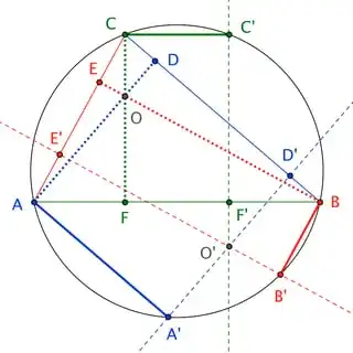

I'll use slightly different notation... with $A^\prime$ for $A_1$, etc. I'll also refer to what I introduced (and proved) as "Ortha's Theorem" in this answer.
Ortha's Theorem. Orthians* at points $D$, $E$, $F$ on respective sides $\overline{BC}$, $\overline{CA}$, $\overline{AB}$ concur if and only if $$|\overline{BD}|^2 + |\overline{CE}|^2 + |\overline{AF}|^2 = |\overline{DC}|^2 + |\overline{EA}|^2 + |\overline{FB}|^2 \qquad (\star)$$
*An "orthian" is a line perpendicular to the side of a triangle at a given point.
Let $D$, $E$, $F$, $D^\prime$, $E^\prime$, $F^\prime$ be the feet of perpendiculars from $A$, $B$, $C$, $A^\prime$, $B^\prime$, $C^\prime$ to the sides of $\triangle ABC$ as shown.
Observe that, since $\overline{AB}$ and $\overline{CC^\prime}$ (as parallel chords of the circumcircle) are bases of an isosceles trapezoid, we must have
$$|\overline{BD^\prime}| = |\overline{DC}| \qquad \text{and} \qquad |\overline{D^\prime C}| = |\overline{BD}|$$
Likewise,
$$|\overline{CE^\prime}| = |\overline{EA}| \qquad |\overline{E^\prime A}| = |\overline{CE}| \qquad |\overline{AF^\prime}| = |\overline{FB}| \qquad |\overline{F^\prime B}| = |\overline{AF}|$$
Therefore, by Ortha's Theorem, orthians $\overleftrightarrow{AD}$, $\overleftrightarrow{BE}$, $\overleftrightarrow{CF}$ concur if and only if orthians $\overleftrightarrow{AD^\prime}$, $\overleftrightarrow{BE^\prime}$, $\overleftrightarrow{CF^\prime}$ concur (since $(\star)$ holds in both cases, or in neither). It is well-known that the former trio (as altitudes of $\triangle ABC$) concur at the triangle's orthocenter, $O$; thus, the latter trio concur, as well. $\square$
