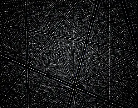

Consider the subset $S$ of $\mathbb{R}^3$ consisting of points whose coordinates are integers (compare Gaussian integers, Euclid's orchard). The view of $S$ from a perspective camera within the space has interesting structure; it has visible density variations that indicate planes intersecting the viewpoint with rational slopes, and the image can be interpreted as many different three-dimensional structures.
Example
This image is actually of a finite subset of $S$, cubical and centered around the camera. (Increasing the number of points would narrow the width of the black empty regions.)
The question: I would like a practical-to-compute function for rendering the infinite-grid version of this image; that is, a function from a direction (and perhaps a small solid angle for the pixel size) to a brightness for the pixel. I'm not sure whether that result should be:
