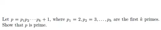

The proofs given on other sites weren't that clear and used different methods that I have yet to learn.
Prove that there are an infinite number of primes of the form 6n+1.
The hint that was given was: Let p = p1, p2, ..., pk + 1, where p1 = 2, p2 = 3,...pk are the first k primes. Show that p is prime.
(p1 means p sub 1, p2 means p sub 2, and pk is p sub k. Wasn't sure how to write it on this.)
Can someone explain this hint on how they came about of p1 = 2, p2=3, etc, and prove this please?
Also, how would the proof change if the form changed? ("Prove that there are infinite number of primes of the form....")
  • If the hint means a product of primes plus $1$, it is wrong: if you take the first $6$ primes you get $2\times3\times5\times7\times11\times13+1=30031$, which is $59\times509$. – David Feb 11 '14 at 03:48
  • I noticed that as well, but wasn't sure if they continued taking primes. How would I prove this if I didn't use the hint? – mshell47812 Feb 11 '14 at 03:50
    Are you sure it is not $6n-1$. The hint is often used to prove for $6n-1$. I can provide a simple proof for that, if you want. Not sure how to use the hint for $6n+1$ – user44197 Feb 11 '14 at 03:52
  • There is a result (Dirichlet's Theorem) which says that there are always infinitely many primes of the form $an+b$, as long as $a$ and $b$ have no common factor. However this is a very difficult result and I doubt it's what you're looking for. There are simple proofs for certain cases, such as $4n-1$ and $6n-1$, and $4n+1$ is a bit harder but not too hard. – David Feb 11 '14 at 03:55
  • I added a picture of what I am looking at. However, how would the proof look like if it were 6n-1? Maybe I can get an idea if I looked at it. – mshell47812 Feb 11 '14 at 04:03
  • See my answer below for $6n-1$. – user44197 Feb 11 '14 at 04:13
