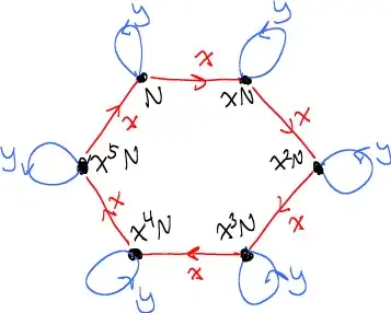

Finding generators for $N$ involves something called a Schreier graph. This is a directed graph defined as follows:
  • It has one vertex for each coset of $N$ in $G$ (so six vertices total)
  • There is a directed edge labeled $x$ from each coset $aN$ to the coset $xaN$, and a directed edge labeled $y$ from each coset $aN$ to the coset $yaN$. (Thus there will be $12$ edges total, $6$ labeled $x$ and $6$ labeled $y$.)
For the case you are looking at, the six vertices are $N,xN,x^2N,\ldots,x^5N$. These six vertices are arranged in a directed hexagon of $x$ edges), and each vertex has a loop labeled $y$: alt text
Note that each path in this graph corresponds to a word in $x$ and $y$, with backwards travel along directed edges corresponding to inverse generators. In particular, the elements of $N$ are the paths that start and end at the vertex $N$.
Now, the statement that is true is that generators for $N$ are the same as generators for the fundamental group of this graph, using $N$ as the basepoint. In this case, what that means is that $N$ is generated by the following elements: $$ A=x^6,\quad B_0 = y,\quad B_1 = xyx^{-1},\quad B_2 = x^2yx^{-2},\quad\ldots,\quad B_5 = x^5yx^{-5} $$ (In general, one can obtain generators for the fundamental group of a graph by first choosing a spanning tree for the graph, and then considering all closed paths starting at the basepoint that pass through exactly one edge not in the spanning tree. In this case, the spanning tree consists of the first five edges of the hexagon.)
