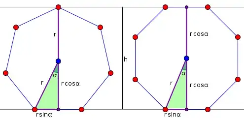

Let $r$ be the radius of the circumcircle of the polygon. From this you get the perimeter as
$$s=2nr\sin\tfrac\pi n$$
This is becuse you can divide your polygon into $n$ isosceles triangles, and dividing each gives $2n$ congruent right triangles, each of which has a central angle of $\alpha=\frac{360°}{2n}$ and a hypothenuse of length $r$. This is the green triangle in the following image:
Illustration
But what is the height of the polygon, in terms of $r$? For even $n$ you'd get
$$h=2r\cos\tfrac\pi n$$
since from bottom edge to midpoint as well as from midpoint to top edge, you have one of the legs of such a right triangle. So for even $n$ you get
$$s = 2n\frac{h}{2\cos\tfrac\pi n}\sin\tfrac\pi n=nh\,\tan\tfrac\pi n$$
This is the result you had yourself already. But for odd $n$, the length from center to top vertex is $r$, so your total height is
$$h = r\left(1+\cos\tfrac\pi n\right)$$
and the perimeter is correspondingly
$$s=2n\frac{h}{1+\cos\tfrac\pi n}\sin\tfrac\pi n$$
Wolfram Alpha will help you find a shorter formula for that as well:
$$s=2n\frac{h}{1+\cos\tfrac\pi n}\sin\tfrac\pi n=2nh\cot\tfrac\pi{2n}$$
I guess you can find a geometric explanation for that formula if you consider the regular $2n$-gon, but I'll leave it at that for now.
