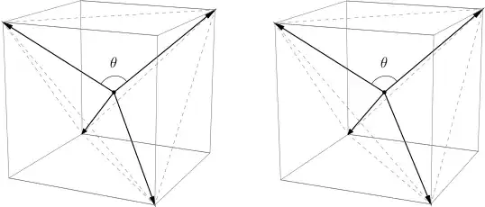

With dot products: Taking the axis-oriented cube of side length $2$ centered at the origin, you're looking for the angle $\theta$ between (say) the vectors $\mathbf{u} = (1, -1, 1)$ and $\mathbf{v} = (-1, 1, 1)$: $$ \cos\theta = \frac{\mathbf{u} \cdot \mathbf{v}}{\|\mathbf{u}\|\, \|\mathbf{v}\|} = -\frac{1}{3}. $$ In response to Dave Renfro's request for a diagram (his triangles are bounded by a pair of vectors and a dashed line), here's a crossed-eyes stereogram:
Tetrahedral stereogram
