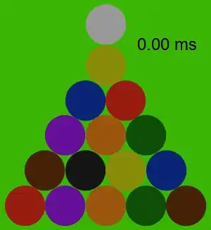

The Collision
For this model, the entire collision takes place in the first 0.2 milliseconds, and none of the balls overlap by more than 0.025% of their radius during the collision. (These figures are model dependent -- real billiard balls may collide faster or slower than this.)
The following animation shows the forces between the balls during the collision, with the force proportional to the area of each yellow circle. Note that the balls themselves hardly move at all during the collision, although they do accelerate quite a bit.

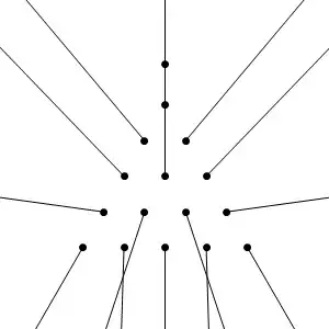

The following picture shows the trajectories of the billiard balls after the collision.

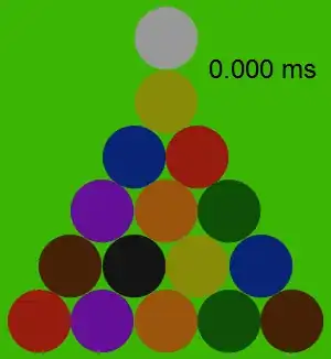

Here is a simulation involving a reasonably "stiff" force law $$ F \;=\; \begin{cases}0 & \text{if }d \geq 2, \\ 10^{54}(2-d)^{10} & \text{if }d<2.\end{cases} $$
As you can see, the result is very similar to my first answer below. This seems like good evidence that the behavior discussed in my first answer is indeed the limiting behavior in the case where the stiffness goes to infinity.
As you might expect, most of the energy in this case is transferred very quickly at the beginning of the collision. Almost all of the energy has moves to the back corner balls in the first 0.02 milliseconds. Here is an animation of the forces:
After that, the corner balls and the cue ball shoot out, and the remaining balls continue to collide gently for the next millisecond or so.

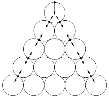

The two balls in the back corners shoot away along rays parallel to the two sides of the triangle. Here is a picture showing the forces, with each force vector emanating from the point of contact.

    Yeah, but ball 2 (balls are numbered 0-15) touches ball 4 and 5. I think the impact will be allocated to 4 and 5 by a ratio of 2:1. (Although there might be a $\pi$ involved.) – Řídící Jan 31 '14 at 20:58
  • @GlenTheUdderboat I don't think so. The force on ball 2 is entirely from its contact with ball 1. This is a normal force, so it has to be perpendicular to the tangent planes, i.e. parallel to the vector from the center of ball 1 to the center of ball 2. The forces that ball 2 exerts on balls 4 and 5 have to add up to the negative of this force vector, only the only such linear combination is that ball 5 exerts no force on ball 2, and ball 4 exerts the same magnitude of force on ball 2 as ball 1 did. – Jim Belk Jan 31 '14 at 21:06
    You almost got me there. :) But you didn't account for ball 2 to move left(ish) after impact. Note that, because of the instantaneity, there is no physical causality or intuition to assume. – Řídící Jan 31 '14 at 21:13
    I don't believe your explanation in the comment, Jim. Note that your argument applies just as well to the situation where only balls 1, 2, 4, and 5 were present; your argument would conclude that ball 5 doesn't move at all, which is false. – Greg Martin Jan 31 '14 at 21:32
    @GlenTheUdderboat Part of what's going on with this problem is that conservation of momentum and energy do not completely determine the solution. The solution I gave certainly obeys both, because it's what would happen if the six balls not along the sides were removed. – Jim Belk Jan 31 '14 at 22:35
