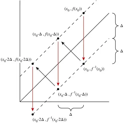

Suppose that, for some $x_0$, $$ f(x_0)-x_0=\Delta\tag{1} $$ where $\Delta\ne0$. By the hypothesis, $$ f^{-1}(x_0)=2x_0-f(x_0)=x_0-\Delta\tag{2} $$ Thus, subtracting $x_0$ from $(2)$ gives $$ f^{-1}(x_0)-x_0=-\Delta\tag{3} $$ Considering $(1)$ and $(3)$, we may assume $\Delta\gt0$ by switching the roles of $f$ and $f^{-1}$.
Applying $f$ to $(2)$ yields $$ f(x_0-\Delta)=x_0\tag{4} $$ which gives $$ f(x_0-\Delta)-(x_0-\Delta)=\Delta\tag{5} $$ which is $(1)$ shifted by $\Delta$. Therefore, inductively, we get $$ f(x_0-k\Delta)-(x_0-k\Delta)=\Delta\tag{6} $$ and $$ f^{-1}(x_0-k\Delta)-(x_0-k\Delta)=-\Delta\tag{7} $$ $\hspace{3cm}$enter image description here
Since $\Delta\gt0$, we can find a $k$ so that $x_0-k\Delta\ge0$ and $x_0-(k+1)\Delta\lt0$. For this $k$, $(7)$ says $$ f^{-1}(x_0-k\Delta)=x_0-(k+1)\Delta\lt0\tag{8} $$ but $f^{-1}:[0,1]\mapsto[0,1]$.
Thus, $\Delta=0$, and therefore, $f(x)=x$.
