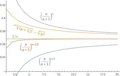

Asymptotic Expansions
This is not what I would call simple, but it does show that, at least asymptotically, the initial inequality is true.
Using the Euler-Maclaurin Sum Formula, we get the formula $$ \log(n!)=\frac12\log(2\pi n)+n\log(n)-n+\frac1{12n}-\frac1{360n^3}+\frac1{1260n^5}+O\!\left(\frac1{n^7}\right)\tag7 $$ and therefore, $$ \frac1n\log(n!)=\log(n)-1+\frac12\frac{\log(2\pi n)}n+\frac1{12n^2}-\frac1{360n^4}+\frac1{1260n^6}+O\!\left(\frac1{n^8}\right)\tag8 $$ The constant $\frac12\log(2\pi)$ is gotten elsewhere (e.g. see this answer).
Using $\log(n+1)=\log(n)+\frac1n-\frac1{2n^2}+\frac1{3n^3}-\frac1{4n^4}+\dots$, we get $$ \log((n+1)!)=\frac12\log(2\pi n)+(n+1)\log(n)-n+\frac{13}{12n}-\frac1{2n^2}+O\!\left(\frac1{n^3}\right)\tag9 $$ and therefore, using $\frac1{n+1}=\frac1n-\frac1{n^2}+\frac1{n^3}-\frac1{n^4}+O\!\left(\frac1{n^5}\right)$, we get $$ \scriptsize\frac1{n+1}\log((n+1)!)=\log(n)-1+\frac12\frac{\log(2\pi n)}{n}+\frac1n-\frac12\frac{\log(2\pi n)}{n^2}+\frac1{12n^2}+O\!\left(\frac{\log(n)}{n^3}\right)\tag{10} $$ Exponentiating $(8)$ and $(10)$ and subtracting gives $$ \bbox[5px,border:2px solid #C0A000]{\sqrt[n+1]{(n+1)!}-\sqrt[n]{n!}=\frac1e\left(1+\frac1{2n}-\frac{5+3\log(2\pi n/e)^2}{24n^2}+O\!\left(\frac{\log(n)^3}{n^3}\right)\right)}\tag{11} $$ Using $\log\left(\frac{n}{n+1}\right)=-\frac1n+\frac1{2n^2}-\frac1{3n^3}+O\!\left(\frac1{n^4}\right)$ yields $$ \bbox[5px,border:2px solid #C0A000]{\left(\frac{n}{n+1}\right)^n=\frac1e\left(1+\frac1{2n}-\frac5{24n^2}+O\!\left(\frac1{n^3}\right)\right)}\tag{12} $$ and $$ \bbox[5px,border:2px solid #C0A000]{\left(\frac{n}{n+1}\right)^{n+1}=\frac1e\left(1-\frac1{2n}+\frac7{24n^2}+O\!\left(\frac1{n^3}\right)\right)}\tag{13} $$ Thus, asymptotically, $$ \left(\frac{n}{n+1}\right)^n-\left(\sqrt[n+1]{(n+1)!}-\sqrt[n]{n!}\right)\sim\frac{\log(2\pi n/e)^2}{8n^2}\tag{14} $$ which is far smaller than $$ \left(\frac{n}{n+1}\right)^n-\left(\frac{n}{n+1}\right)^{n+1}\sim\frac1{en}\tag{15} $$
Graphical Comparisons
Graphically, we can see the size difference between $(14)$, the distance between the top two functions, and $(15)$, the distance between the top and bottom functions.
