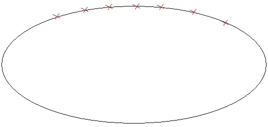

How can I calculate an ellipse from a group of points ?
Result: center point, x-radius, y-radius ?
I'm not mathematician so I don't really know the best parameter style for ellipses. This ellipse is aligned to X and Y axes and I usually go with center point and 2 radii in x and y directions.
