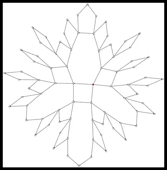

It's this last reduced graph that I'm particularly curious about: is it planar?
An excellent question! I've been trying to find an answer to it, but haven't so far. To my knowledge, it's open.
Here's what $B_{10}$ in the Cayley graph of Grigorchuk group looks like when the $abcd$ "kites" are collapsed and leaves removed:
A ball in the (reduced) Cayley Graph of the Grigorchuk Group with the standard set of generators
Here, $B_{10}$ is the ball of words of length 10 or less around identity, with the standard generating set. Each node represents the $K_4$, and each edge corresponds to $a$.

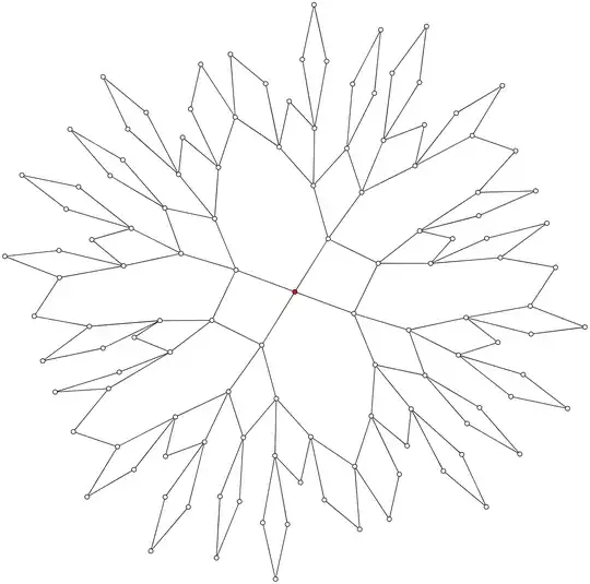

The graph was laid out with Graphviz (neato engine), as is the next one, for $B_{11}$: Reduced Cayley graph of the Grigorchuk group with standard generators
I haven't checked whether the larger graphs are planar, but I'd conjecture that they are.
I also didn't experiment enough with edge lengths; these two embeddings are quasi-isometric due to how layout engine works when unconstrained
Certainly a very interesting question, and I didn't yet give up hope of exploring it deeper some day :)
