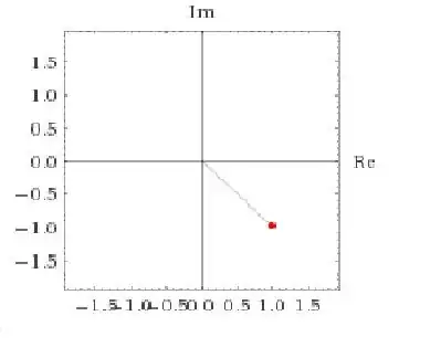

Hint: $1-i=\sqrt 2e^{-i\pi/4}{}{}{}{}$.
To find the above equality you can think about it geometrically and use the known techniques:
Triangle
Or algebraically by proving that given any $a,b\in \mathbb R$, it holds that $a+ib=\sqrt{a^2+b^2}e^{i\arg(a+ib)}$, where $$\arg(a+ib)=\begin{cases} \arctan(b/a), &\text{if }a>0\\ \pi /2, &\text{if }a=0\land b>0\\ \arctan(b/a)+\pi, &\text{if }a<0\\ -\pi/2, &\text{if }a=0\land b<0\end{cases}$$

  • How did you just know what the angle is and what r is? – Mr Croutini Jan 05 '14 at 12:12
  • @MrCroutini Plot the point $1-i$ or $(1,-1)$ in the plane; one unit east, one unit south of the origin. $\ \ r$ is the distance from $(1, -1)$ to $(0,0)$: $\sqrt((1)^2+(-1)^2)=\sqrt(2)$ by the distance formula. – bof Jan 05 '14 at 12:17
  • $\theta$ is the angle the line from the origin to $1-i$ makes with the positive $x$-axis. Note that that line bisects the angle between the positive $x$-axis and the negative $y$-axis, so the angle is $-45^0$ or $-\pi/4$ radians. – bof Jan 05 '14 at 12:21
