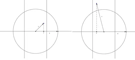

For larger dimensions, it gets ugly. Couldn't find anything nice for the 2 dimensional case, so let's go :
Inner working :
You have two vectors $u$ and $v$, sorted by euclidean length. We define the coefficient $\mu=\dfrac{u\cdot v}{\|u\|^2}$. that coefficient $\mu$ represents the relative length of the projection of $v$ over $u$ (see picture below). Then making the vector $v$ as short as possible is done by removing $\lceil \mu \rfloor \times u$ from $v$. We get a new vector $v$ such that one of the following happens :
after size-reduction
the new $\mu$ is in $\left[-\dfrac{1}{2};\dfrac{1}{2}\right]$, meaning that the $v$ vector is inside the two vertical bars. This is called size-reduced.
On the left side the vector $v$ is inside the circle of radius $\|u\|$, meaning that $v$ is now shorter than $u$. Therefore swapping position of $u$ and $v$ will yield $|\mu|>\dfrac{1}{2}$ (you can see it by projecting $u$ on $v$)
On the right side however, $v$ is outside the circle (the Lovasz condition is said to be verified) and therefore swapping the places of $u$ and $v$ wouldn't yield anything. The basis is said LLL-reduced, and $u$ is the shortest non-zero vector of the lattice.
