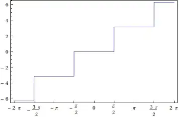

At least for $\arctan(a\tan\,x)$, one can build a modification of the function that does not have jump discontinuities. The route is to use, instead of the floor function, the function
$$x-\arctan\tan\,x$$
which is also piecewise constant:
plot of x-\arctan\tan\,x
The function we need is thus
$$x+\arctan(a\tan\,x)-\arctan(\tan\,x)$$

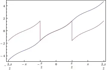

Compare the functions $\color{#3f3d99}{x-\arctan\left(\dfrac{(1-a)\sin\,2x}{1+a+(1-a)\cos\,2x}\right)}$ and $\color{#993d71}{\arctan(a\tan\,x)}$ (for $a=2/3$):
\arctan(a\tan\,x) and its continuous modification
