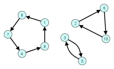

You can interpret a permutation as a directed graph: The nodes are the numbers $1,\dots,n$ and there is an arrow from $a$ to $b$ if the permutation $\pi$ maps $\pi(a)=b$. This is a functional graph and as the number of nodes is finite and the map is one-to-one, every node has exactly one in-edge and exactly one out-edge. It is clear that this graph must be a set of disjoint cycles (hence the name).
Of course this is only a picture to the proof, to show where it comes from. The proof is correct because we can easily check that $S_n$ indeed acts on $X$ and orbits are cycles.
EDIT: Someone requested a real picture, not only a sketch of the proof. So I add one showing the corresponding graph of the permutation $\left(\begin{eqnarray} 1&2&3&4&5&6&7&8&9&10 \\ 8&6&5&9&3&10&4&7&1&2 \end{eqnarray}\right)$.

  • What happened to the picture that you mention in your last paragraph? Can it be linked or uploaded back? –  Jan 19 '14 at 07:24
  • @FrankMuer I meant a sketch, not a picture. Sorry for using the wrong word. I added a picture in order to make it correct. – benh Jan 19 '14 at 15:13
  • Exquisite picture. Thanks a lot. Upvoted. No problem. What'd you flesh it out with? –  Jan 20 '14 at 13:25
    @FrankMuer Thanks, that's yEd graph editor. – benh Jan 28 '14 at 12:35
