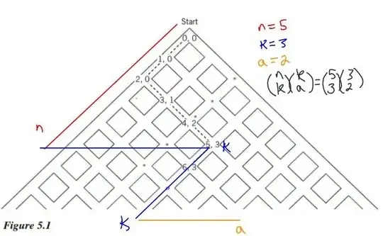

For anyone familiar with the "block-walking" interpretation of Pascal's triangle, how would you show the same identity with a block-walking argument?
For those not familiar with block-walking, please observe the following without a rigorous argument. There are $\binom{4}{2}$ possible paths to reach the point $(4,2)$ in the triangle below, since every path to $(4,2)$ requires $2$ traversals in the direction right out of $4$ traversals total. As another example, there are $\binom{2}{0}$ paths to reach $(2,0)$. In general,there are $\binom{n}{k}$ ways to reach the point $(n,k$).
An example of a "block-walking" combinatorial argument for Pascal's identity might be as follows. Observe that the count of possible ways to reach a point $(n,k)$ is exactly the sum of the possible ways to reach the two points which lead to it, namely $(n-1,k-1), (n-1,k)$. To say this algebraically, $\binom{n-1}{k-1} + \binom{n-1}{k} = \binom{n}{k} $.

    Have you been able to translate the committee argument to the lattice path model (a $k$-subset of ${1, 2, \dots, n}$ corresponding to an ordered sequence of $n-k$ left turns and $k$ right turns as you walk from $(0,0)$)? The interpretation you get is not particularly natural in terms of paths, so I'm not sure there is going to be a 'simple' proof using the lattice path model. – Michael Joyce Dec 29 '13 at 23:37
  • @MichaelJoyce I don't really know what lattices are, or at least I haven't studied them. No, I did not come up with a translation of the committee argument. – NaN Dec 30 '13 at 01:21
    The lattice path model is just the name I was using for your "block-walking" interpretation. To go from $(0,0)$ to $(n,k)$, you take a total of $n$ steps, $k$ to the right and $n-k$ to the left. So you can think of such a path as being determined by which $k$ of the steps $1,2,\dots,n$ that you go right (going left for the other $n-k$ steps). If you translate the committee argument to the block-walking interpretation, you'll get Ragnar's solution. – Michael Joyce Dec 30 '13 at 03:32
  • @MichaelJoyce, I wanted to make some other comments, but it appears that I only have time to explain that my textbook calls this"Block-walking". I am not sure know why the textbook doesn't just name this Lattice path model. Maybe it's so the author can avoid defining lattices? – NaN Jan 02 '14 at 09:52
  • @MichaelJoyce, there are a few more lattice path model proofs of combinatorial identities, which I'd be glad to write. Maybe some insight could be picked up and applied to the OP proof. Would this belong in the comments section? – NaN Jan 02 '14 at 09:59
    FWIW, while the term lattice path is somewhat standard, I don't think lattice path model is standard. I think your text probably used the term block-walking because it is more intuitive and less technical, certainly good things to have in terminology. If you want to include proofs that you think may be relevant to answering your question, the best place is probably as an edit to your original question. (Just indicate what part has been edited so people coming back to your question will know there is new information available.) – Michael Joyce Jan 02 '14 at 13:41

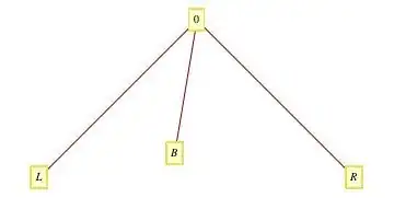

I'm not able to come up with an argument that is fundamentally different from the "committee argument", but it is possible to cast the entire proof in geometric terms if one is willing to move into the third dimension.
Consider a three-dimensional grid analogous to your two-dimensional one. Your grid is a quadrant of an infinite two-dimensional grid; the three-dimensional analogue would be an octant of an infinite three-dimensional grid. In your grid, there are two directions in which one can move, left and right. A point in your grid is given by coordinates $(n,k),$ where $n\ge0$ is the total number of steps and $k$ ($0\le k\le n$) is the number of right steps. In the three-dimensional version, there are three directions in which one can move, which we will call left, right, and back. (Think of "back" as the direction into the page.) A point in the grid can be given coordinates $(n,k,a),$ where $n$ is the total number of steps, $k$ ($0\le k\le n$) is the number of left and right steps (that is, non-back steps), and $a$ ($0\le a\le k$) is the number of left steps.enter image description here
The two sides of your identity both equal the number of three-dimensional grid paths joining $(0,0,0)$ to $(n,k,a),$ and correspond to different ways of decomposing a three-dimensional grid path into two two-dimensional grid paths. In two dimensions, the two directions of movement might be given coordinates $$ L:\ \left(-\frac{1}{\sqrt{2}},-\frac{1}{\sqrt{2}}\right),\qquad R:\ \left(\frac{1}{\sqrt{2}},-\frac{1}{\sqrt{2}}\right). $$ In three dimensions, the three directions might be given coordinates $$ L:\ \left(\frac{1}{\sqrt{2}},\frac{1}{\sqrt{6}},-\frac{1}{\sqrt{3}}\right),\qquad R:\ \left(-\frac{1}{\sqrt{2}},\frac{1}{\sqrt{6}},-\frac{1}{\sqrt{3}}\right),\qquad B:\ \left(0,-\sqrt{\frac{2}{3}},-\frac{1}{\sqrt{3}}\right). $$ If we project out the $x$-coordinate in this coordinate system, then left and right steps look the same: both correspond to a move which we might call "front", $$ F:\ \left(0,\frac{1}{\sqrt{6}},-\frac{1}{\sqrt{3}}\right). $$ A path from $(0,0,0)$ to $(n,k,a)$ then consists of $k$ front steps and $n-k$ back steps. The number of such paths is $\binom{n}{k}.$ If we project out the back coordinate, that is, we project onto the plane of the left and right steps, then we effectively remove all back steps from the path. Such a path then consists of $k$ steps, $a$ of which are left steps, and $k-a$ of which are right steps. There are $\binom{k}{a}$ such paths. The number of three-dimensional paths is given by the product of the numbers of paths in these two projections, which is the left side of your identity.
To get the right side of the identity, we perform a projection so that right and back steps look like each other and left steps are unchanged. (It's not terribly relevant to the combinatorics, but this projection is achieved by the map $v\mapsto v-(n\cdot v)n$ where $$ n=\left(\frac{1}{2},-\frac{\sqrt{3}}{2},0\right) $$ is the unit vector orthogonal to the $L$ direction and the $z$ axis. Under this projection, the $R$ and $B$ directions both map to $$ N:\ \left(-\frac{1}{2\sqrt{2}},-\frac{1}{2\sqrt{6}},-\frac{1}{\sqrt{3}}\right). $$ Here $N$ stands for "non-left".) The three-dimensional path then projects to a path consisting of $a$ left steps and $n-a$ non-left steps. There are $\binom{n}{a}$ such paths. If we project onto the plane of the right and back steps, which effectively removes left steps, we are left with a path of $n-a$ steps, $k-a$ of which are right steps and $n-k$ of which are back steps. There are $\binom{n-a}{k-a}$ such paths. Again, the number of three-dimensional paths is given by the product of the numbers of paths in these two projections.
This is, of course, the committee argument: the left and right steps are the committee members, and the left steps are the special committee members. The back steps are the non-members of the committee.
Added: In my opinion, the best way to look a the identity was given in Marc van Leeuwen's answer here. Let $b=k-a$ and let $c=n-k$ so that $k=a+b$ and $n=a+b+c.$ Then the identity becomes $$\binom{n}{a+b}\binom{a+b}{a}=\binom{n}{a}\binom{n-a}{b},$$ which can be rewritten as $$\binom{n}{c}\binom{n-c}{a}=\binom{n}{a}\binom{n-a}{b}.$$ The latter consists of two pieces of the six-way identity $$\begin{aligned} \binom{n}{a}\binom{n-a}{b}=\binom{n}{a}\binom{n-a}{c}&=\binom{n}{b}\binom{n-b}{a}=\binom{n}{b}\binom{n-b}{c}\\ &=\binom{n}{c}\binom{n-c}{a}=\binom{n}{c}\binom{n-c}{b} \end{aligned}$$ in which the roles of $a,$ $b,$ and $c$ have been permuted in all possible ways. These correspond to six different ways of writing the trinomial coefficient $$ \binom{n}{a,b,c}=\frac{n!}{a!\,b!\,c!}. $$ The six-way identity is easy to show since all six expressions telescope to give the right hand side of the formula above. For example, $$ \binom{n}{b}\binom{n-b}{a}=\frac{n!}{b!(n-b)!}\frac{(n-b)!}{a!(n-a-b)!}=\frac{n!}{a!\,b!\,c!}, $$ where we have used $n-a-b=c.$ The same proof works for all six expressions.
In terms of the geometric picture I outlined above, the first two of the six expressions correspond to projecting so that right and back steps look alike, and then projecting onto the plane of right and back steps; the second two correspond to projecting so that back and left steps look alike, and then projecting onto the plane of back and left steps; the last two correspond to projecting so that left and right steps look alike, and then projecting onto the plane of left and right steps. In each pair, both expressions count the same thing: for example, in the first pair, $\binom{n-a}{b}$ and $\binom{n-a}{c}$ both count the number of paths consisting of $b$ right steps and $c$ back steps.
